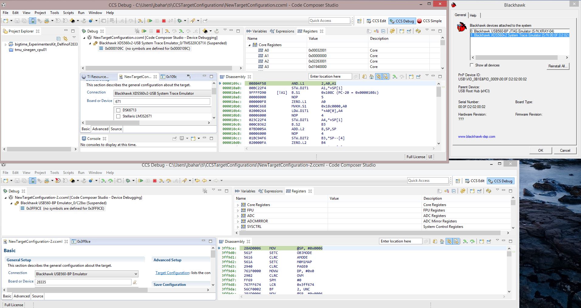

  • Josh,
    Unfortunately I don't have a XDS560LAN from Blackhawk, but I checked with their engineers and they were able to run your #2 scenario without problems - i.e., running a XDS560v2 and a USB560bp in two instances with separate workspaces (check attached).
    The screen also shows the Blackhawk utility that shows both emulators connected with different port access numbers. Port access numbers only need to be updated in the .ccxml file if you are using the same emulator driver (i.e., two identical emulators). Just FYI: if you were using the same emulator, when you open the Blackhawk control panel it will prioritize the emulators in a list that can be used to designate the port number in the CCXML.
    Their setup is Windows 8.1 + CCSv6.0 + XDS560v2 -> C6711 + USB560BP -> F28335
    In the meantime I am trying to obtain a USB560bp and see if I can try to reproduce this locally.

  • Rafael,
    Thank you for looking into this for me.
    Their setup is a little different.  I am using Windows 7, and I am also talking to two identical targets (AM3359).  Also, I didn't change the port access numbers.  You mention that they don't need to change, but I suppose I could change them and see if the behavior is any different.
    One thing to note--I was able to connect to both targets using two instances of CCS.  The problems occurred when I started working with the two systems.  And the behavior was not always consistent.  I believe the most consistent issue I saw was that with the target running in the first instance, if I started the running the target in the second instance, and then halted the second target, the second instance of CCS would close.
    So if this is supposed to work, why does the wiki link above suggest that it won't work?
    --Josh
  • Josh,
    Yes, I asked the engineer from BH to try using the same device, but I am unsure if he has two boards available. Historically we know the different OS version has very minimal influence on these scenarios.
    I am looking at the page and apparently this is only valid between XDS560v2 and XDS200 (these emulator classes share the same drivers). I will edit the page.
    Rafael
