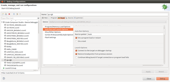

    One detail I just thought about it is that you can try to change the Debug Configuration settings in CCS. Terminate the debug session then go to menu Run --> Debug configurations --> select the qs-rgb configuration on the tree on the left and un-check the option Restore breakpoints from previous session as shown below:
    Apart from this, I am unsure on what else to suggest, apart from the Troubleshooting page I sent before (create a new workspace, erase the previous debug configuration settings, erase the temporary files, etc).
