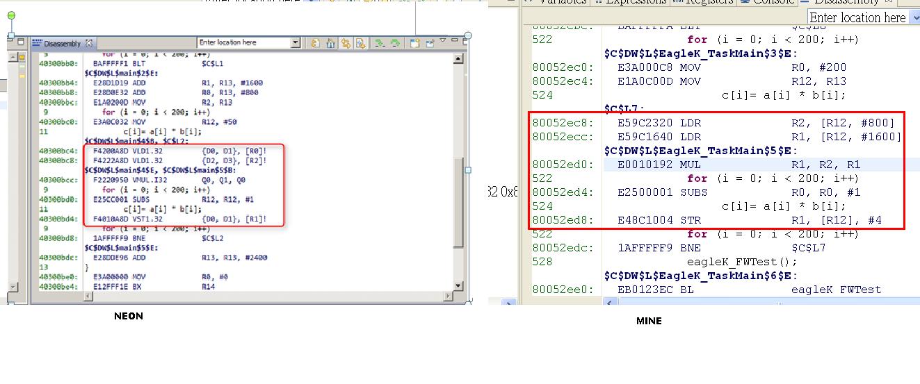

Still, I failed to generate the neon code for my target platform.  From my CCS5.2.1 disassembly window, please
see my assembly code dump compared to the successful one.

  • I can get NEON instructions for that C source.  I suspect something subtle is getting in the way.
    Please send a test case I can build, perhaps preprocessed like this.  Please show the command line options exactly as the compiler sees them, and the compiler version number.

  • I cannot explain why you don't see the NEON instructions.  I filed SDSCM00050200 in the SDOWP system to have this investigated and explained.  If we are lucky, I missed something simple.  Feel free to follow this issue with the SDOWP link below in my signature.

  • The key bit seems to be the presence of the "while(1)" loop.  If I comment out the "while" line, or if I replace it with another for-loop, I get VMUL (and VLD and VST).
    I don't yet have a good explanation why the infinite loop perturbs things in a way that interferes with vectorisation.
  • Hi, pf:
    Yes, after I remove the while(1), I would successfully obtain the neon instruction assembly code for
    the test example code.
    I applied the the rule to my algorithm on cortex A8. Unfortunately, the performance does not see
    significant improvement.
