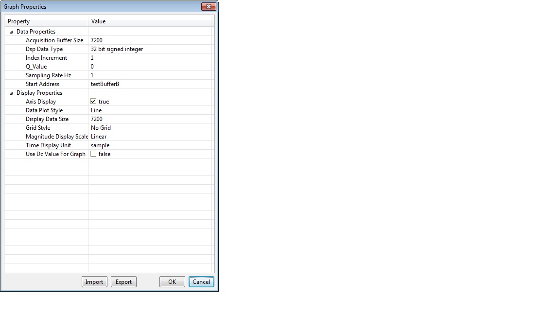

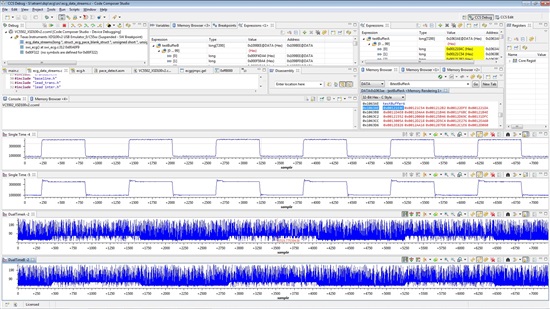

While debugging a VC5502 application on a custom board, I captured input and output data in signed 32-bit integer (Int32) arrays with 7200 elements each. Then, I set a breakpoint in my code. At this point, I tried to use the dual time graph feature of CCSv5.5 to examine the input (testBufferA) and output (testBufferB) of a processing block.
Both graphs look like they were graphed as unsigned 8-bit integer data (Uint8). See below.
Next, I used a single time graph to display the data from testBufferA. That graph looked correct.
I also used another single time graph to display the data from testBufferB. That graph looked correct too.
Here is a screen capture of my CCSv5.5 session with the goofy dual time graph on the bottom (DualTimeA-2 and DualTimeB-2), and the two single time graphs of the same two arrays (Single Time-4, Single Time-5).

    I did take a look at the Dual Graph to plot some data in 2 buffers and tried the same thing with single time (similar to what you did). However I did see the data as desired. Since it is working in the Single Time and on Linux I can rule out any Graph hardware dependent data acquisition problems. Not sure why it is plotting a
    Could you please send me your <workspace>\.metadata\.plugins\com.ti.dvt.graph.visualization (If present). Also try deleting that folder and see if the problem goes away.
    Another experiment which would be helpful in narrowing down the issue....
    Fill byte address location "testBufferB + 7200/4 - 200" till the end of the testBufferB with 0 (could use CCS memory fill). Please send a screen shot of the Single time and Dual time graph with this experimental data pattern (same graph properties as you had, just different data)

  • First, I reproduced the issue on my PC. This time I used a sinusoidal signal. The screen capture shows the dual time graph at the bottom and two single time graphs above the dual time graph.
    My <workspace>/.metadata/.plugins/com.ti.dvt.graph.visualization/ folder contains a savedSolutions/ folder that is empty.
    I filled the testBufferB[1600:7199] with zeroes using the CCSv5.5 memory fill feature and refreshed the graphs. The screen capture is attached.
