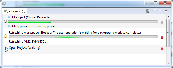

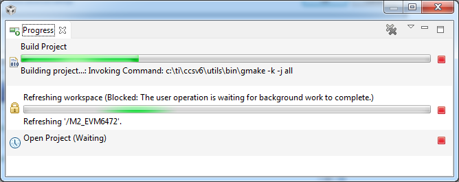

If you have a compiler error like this showing up in the console window
1 fatal error detected in the compilation of "../Twod.cluster/TwoDMultiBeam.module/src/MultiBeam.c".
Compilation terminated.
and then you change a project setting (like adding a new include path), CCSv6 is hung saying that wants to complete the build even though its stated that it terminated the build

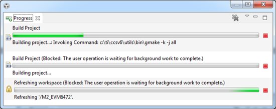

And then when you select build, it kicks off another build session
Can't cancel the build either. I have to use the task manager to shut it down.
