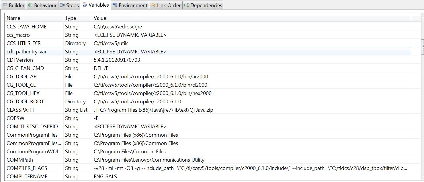

    Can you make sure that the CG_TOOL_HEX variable is correctly pointing to the path to the hex2000 utility?  This variable should show up in the project's properties (you may have to have 'system' variables be shown to see it).
    Thank you,
    Brett
  • Thanks, Brett.
    My project properties showed:
    C:/ti/ccsv5/tools/compiler/c2000_6.1.6/bin/hex2000
    I also tried changing my compiler from 6.1.6 to 6.1.7, 6.1.5, and 6.1.0. The hex utility system property changed accordingly, but the problem persists.

    Can you post the complete output in the CCS build console? You can copy and save it to a text file and then attach it here. Also please attach a screenshot of the build variables in CCS (with system variables enabled) of the section where CG_TOOL_HEX and similar variables are defined.
    My guess is one of your system variables is incorrect.  That's why it would be good to see them.
