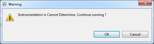

I've stopped the core and go to Tools -> RTOS Analyzer -> Print and Error Logs and then the window pops up saying it "Cannot Determine" the instrumentation status
I clicked on the "Cannot Determine" and got the following
I selected OK and then Start. I then get
After clicking OK, CCS opens up a new window with Live Session and Printf Logs tabs. Both do not contain any data.

    I don't have the same board as you, but I tested it with a C6474EVM and got the exact same messages/dialog boxes as you - although in my case I got Printf data correctly.
    These dialogs/messages are a non-issue, in the sense they only indicate the UIA component installed with CCSv6 (1.40. 0.6) is not able to detect the capabilities of the standalone SYSBIOS/XDC components. I will verify when a standalone UIA 2.x will be available.
    The real issue in your case is the fact you are not able to get data out. I will check what types of logs can be obtained to further debug this. In the meantime, I strongly suggest following the troubleshooting procedures of the sections General IDE and Debugger of the CCSv6 Troubleshooting page.

  • Eddie,
    One detail that one of the developers caught was the fact your first screenshot is indicating you are using UDP as the transport mechanism. Mine shows as Stop-mode JTAG:
    I checked and you could take a quick look at the configuration settings of the LoggingSetup component of your .cfg file. Mine is set to JTAG Stop Mode
    That said, I have no idea how the setting have changed in your .cfg file.

  • Hi
    I shut down CCS, power cycled the evm and only loaded the staircase example. I could get print logs! Yay!
    I think what happened was I had previously loaded the messageQue example on all cores. That example is thinking its NDK even though I set
    LoggingSetup.eventUploadMode = LoggingSetup.UploadMode_JTAGSTOPMODE;
    I had changed it to run UploadMode_JTAGSTOPMODE as you have shown above in your screen shot, but the presence of the following .cfg text makes the system want to use UDP. Strange.
    var ServiceMgr = xdc.useModule('ti.uia.runtime.ServiceMgr');
    ServiceMgr.topology = ServiceMgr.Topology_MULTICORE;
