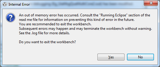

  • Had this happen to me today. I think CCS didn't like me kicking off a build when it was analyzing a .cfg file. I was working on the message que example
    An out of memory error has occurred. Guess I better read the readme file like it suggests.

  • Hi
    Version: 6.0.0.00190
    I was building a large project. The console said the build was completed. I then changed to the message queue example, edited the cfg, then started its build.
    The build status popup would flash on and off the screen.
    Then came the memory error
    Then came the update monitor error
    And finally after waiting a LONG time, I shut down CCS using the task manager and got
    This has happened before, to prior to this crash, I changed my eclipse.ini to give me more memory (I have 18 GB RAM on my PC)
