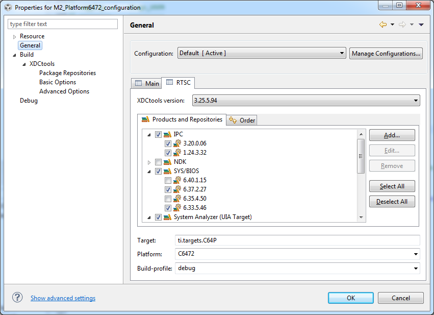

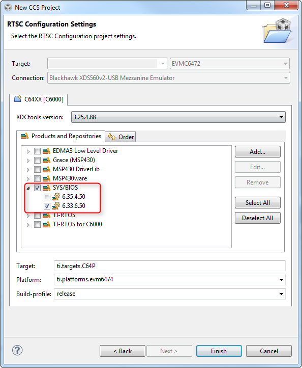

CCSv6 showing multiple RTSC selections of same component
Hi
CCSv6.0.0.00190, ti.platforms.evm6472, stairstep example, System Analyzer 1.4.0.6, CGT 7.4.8, XDX 3.25.5.94, SYS/BIOS 6.37.2.27, XDS560v2 spectrum digital emulator.
Maybe this is because clearcase has some of my configuration files locked, but nonetheless, CCS shouldn't select two versions of the same RTSC component (see screenshot)
The older versions are what I imported the project into CCSv6 with. Then I updated the versions, then closed CCSv6 and started it again. The RTSC shows the
The app and platform .* files are attached
http://e2e.ti.com/cfs-file.ashx/__key/communityserver-discussions-components-files/81/6761.M2_5F00_EVM6472.7z
http://e2e.ti.com/cfs-file.ashx/__key/communityserver-discussions-components-files/81/6281.M2_5F00_Platform6472_5F00_configuration.7z

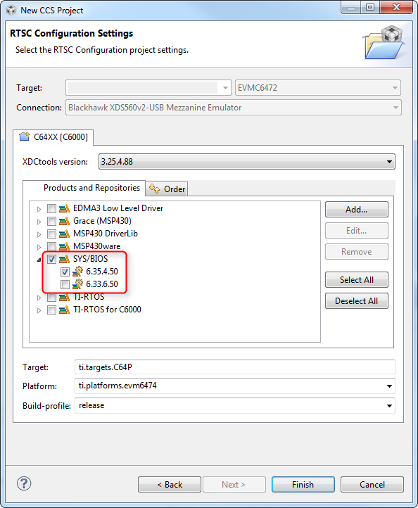

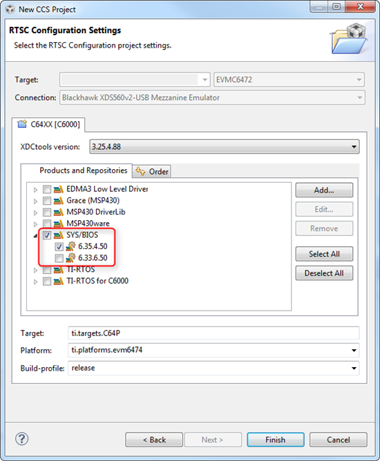

  • Eddie,
    For me I can only select one SYS/BIOS.  Here I select the first one in the list.
    As soon as I check the box beside the 6.33 release the 6.35 one is automatically unselected.
    The tool is not supposed to let you select more than one item that is the "same".  I am going to have to ping the guy that works on this to see what could be going on to trigger you to be able to select more than one.
    John
  • I too have had this problem. When selecting a newer or older version, it deselects the previous one, but if you close and then reopen the properties, 2 versions will be selected. You need to repeat the selection operation to get it to stick. However, if you check the "Includes" directory in the Project Explorer, the correct versions are there (at least for the header files ... )
