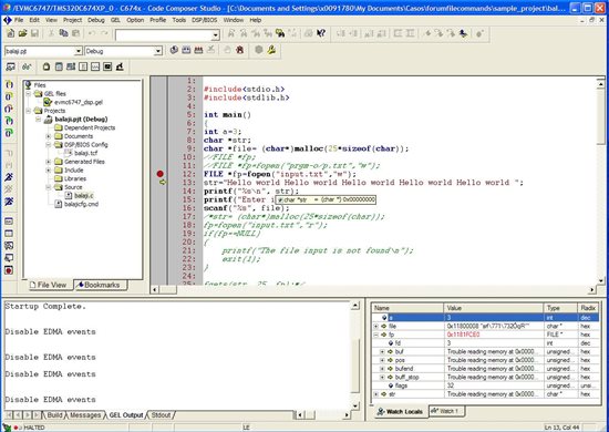

I am using Omap L137 EVM and CCSv3.3. While writing a program on DSP, I used file commands like fopen, fprintf,... but they were not supported( the fopen gave a null pointer). Aren't these commands supported??? Can't we take input from files and write output to files ???

    From the link given here, I understood that heap memory should be enabled and heap size should be given. After doing it, stdout tab appeared, malloc() function is working but not the file commands.
    For my application, I need to read a lot of float data from a file and write float data to files

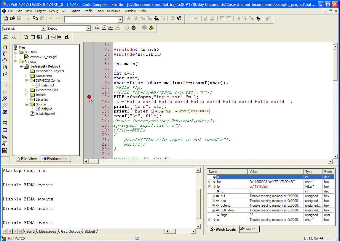

  • John,
    I was able to open the file with your project. I just replaced:
    //FILE *fp=fopen("prgm-o/p.txt","w");
    With:
    FILE *fp=fopen("input.txt","w");
    as there is no prgm-o/p.txt file. Please see figure:
  • what I understand is that the files to be read have to be stored in Debug folder..yeah its reading from the files..
    but the problem is still there...file is opened for writing... but it is not writing to the files...pls check once...
  • Hi John,
    Yes, the files are expected to be in the same folder as your executable (.out), it the file is not in the same folder you need to provide a path to it. I was able to write to input.txt that is in the Debug folder using the following code:
