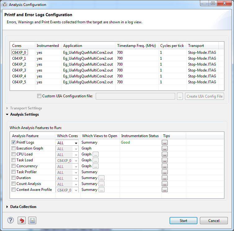

I can get the Printf Logs window to show one of the cores, but it won't update when I click on different cores in the debug window. If I go to the RTOS Object View (ROV) -> LoggerMin->Records, I see the "records" updating each time I select a different core. So this proves that there are logs on the other cores. But the Printf Logs window seem stuck on Core 5 (at least this time, other times its shown core 0 and others core 1).
I did an experiment where I shut down the Printf Logs and Live Session windows, selected core 1, and re-opened the Tools->RTOS Analyzer->Printf and Error Logs. This time the Printf Logs window shows core 4.
In CCSv4, you had to select an enable button in the Printf Logs and then do an assembly step to tell the tool to load and decipher the core's log. The buttons are missing on CCSv6.
All looks good in the Analysis Configuration window.

  • I think I figured out how to open printf windows for each core. When you do Tools->RTOS Analyzer->Printf and Error Logs, two windows open. One is live and the other looks like it defaults to the first core thats setup for logging. To get another core, go to the live window, click on the Analyze button next to the play/pause button. Its dropdown will let you select which core's printf you wish to see.

  • Hi Eddie,
    If you want to use DDR2 for the logs, you should use LoggerStopMode, and not LoggerMin.  With LoggerStopMode, the Log buffer will be split up among the cores so that they will not over-write each others data.  Could you try removing the line:
    LoggingSetup.loggerType = LoggingSetup.LoggerType_MIN;
    in your configuration file and see if that fixes the problem?
        Janet
  • Yay! Thats IT! Bad LoggerType_MIN  :)
