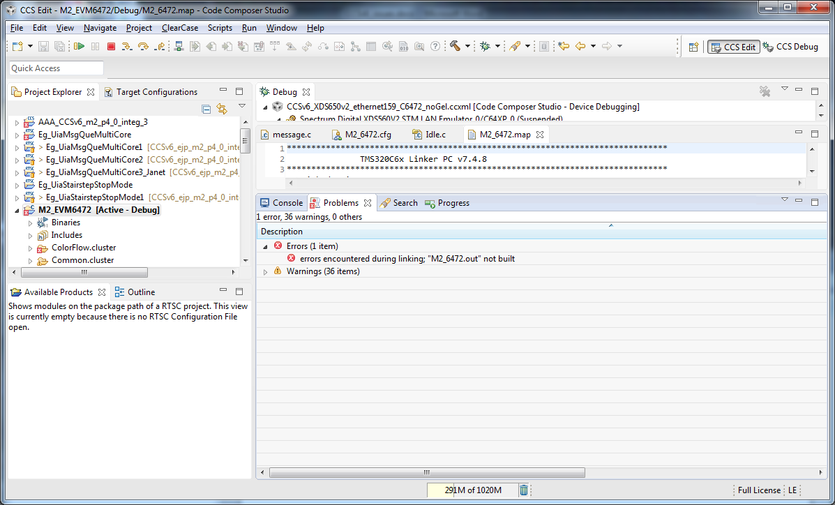

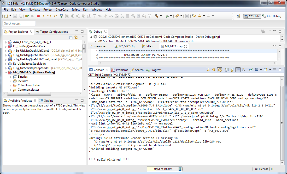

I've build my project successfully as shown in the console window (its created a .out file), but the Problems window thinks the .out file was not built. I've checked to make sure the proper project is active in the project window.
But the problems window thinks there is an error
  • When you do a build, does the problems view get cleared first? I'm curious if that is a left over message from a previous build (I've seen that happen from time to time where the view doesn't clear).
    I also see that CCS has detected an error in the Colorflow.cluster folder. Is there a particular file it is complaining about?

    Sorry Ki-Soo. I've re-started CCS and the problem window now reflects the fact there are no error, just warnings.

    All files compiled OK (as shown in the console window output of the first snapshot). I can't remember when I fixed the colorflow compile bug, but it was awhile ago.
