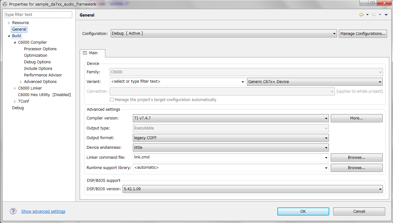

[CCSv6, Debug Perspective] a menu of Tools->RTOS Analyzer->RTA(legacy) is no longer found.
I noticed that CCSv6 Debug Perspective does not have a menu of Tools->RTOS Analyzer->RTA(legacy).
This means legacy BIOS (DSP/BIOS) users can't do any real-time analysis such as CPU Load, LOG printfs, etc.. on CCSv6. I could do the same with CCSv5.x.
Do you have any suggestions to realize real time analysis on CCSv6 ?
Fyi, using SYS/BIOS with UIA tools is not a option because the target device is C672x/DA7xx.
