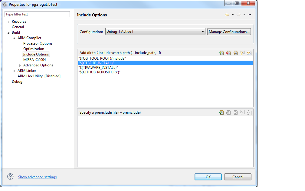

Here is a screenshot of my CCS screen:

I actually have the include path setup already. The file is located at:
C:\Users\cmayberry7\Github\GTBE\gtbelib\pga_pga2311.h
I have this folder in my include path as a variable, GTBELIB_INSTALL which resolves to C:\Users\cmayberry7\Github\GTBE\gtbelib as shown in the screenshots below. I also have another file, tw_extension.h, in the same location which is also used and appears to be included just fine.
Any other ideas?

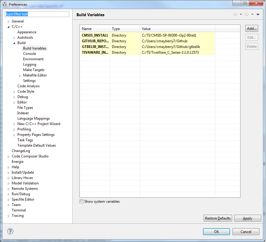

In the first post the --include_path= compiler options all appear to be directories under F:\.Curtis Mayberry1 said:The file is located at:C:\Users\cmayberry7\Github\GTBE\gtbelib\pga_pga2311.h
Yet based upon this post the files are actually under C:\
Is there any path/directory re-direction going on under Windows?

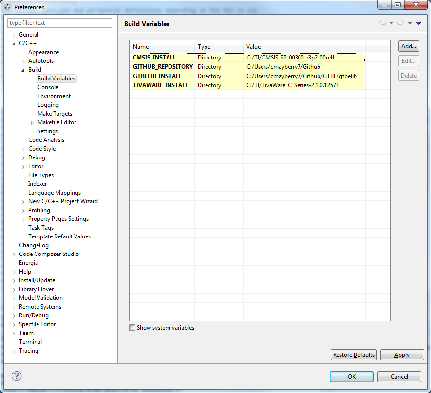

My reading of the screenshot is that that GTBELIB_INSTALL is actually set to point at C:\Users\cmayberry7\GitHub\gtbelib, rather than C:\Users\cmayberry7\Github\GTBE\gtbelibCurtis Mayberry1 said:The file is located at:C:\Users\cmayberry7\Github\GTBE\gtbelib\pga_pga2311.h
Can you post the error from the CCS build console again, so can check that the correct include paths are being passed to the compiler.Curtis Mayberry1 said:Thanks for catching that Chester, as shown below I have corrected that mistake.Unfortunately that didn't help with the error.

I was able to solve this problem by importing my Build Variables into the workspace again and overwriting the current ones. I also deleted the other gtbelib folder so there wasn't any confusion.
I thought I had them set correctly, but I must have been missing one or more other changes that importing that file makes besides setting the build variables.
