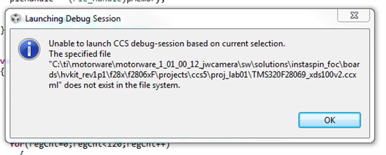

I've imported "Example_2806xSpi_FFDLB_int" from ControlSuite into the CCSv6 workspace, where there are two other projects. There were three projects but I deleted "Proj_lab01" (Instaspin Labs).
When I try to debug the new project  "Example_2806xSpi_FFDLB_int", I get an error message as in the attached image. Why is CCS looking for lab01 when I'm trying to debug a different project  ?

    Regarding this specific question, does your Example_2806xSpi_FFDLB_int project have a target configuration file (.ccxml) associated with it? I suspect it does not, and CCS is trying to use the debug session that was last launched, (which used the .ccxml file within the proj_lab01 folder). but cannot find the .ccxml file as it was deleted. Please create a new target config file for this new project or link to an existing target config file and then you should be able to launch a debug session.
