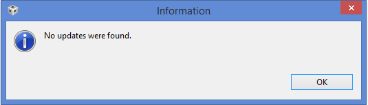

When I try to search for updates "Check for new updates"  CCSV6 Pops up a window:
Saying: There are no update sites to search. Continue with : yes leads to an empty Software site window:
The OS is Windows7 professional - 64 bit.
What is wrong here?

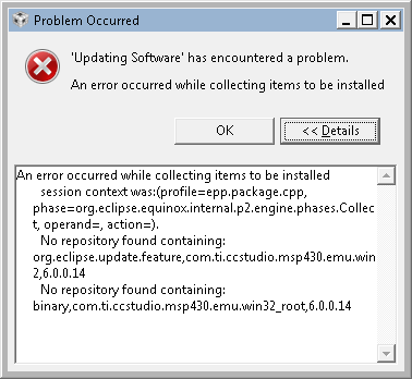

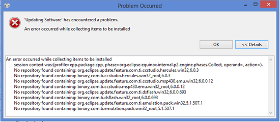

  • This does not answer my question, "try it after some time" is not an "engineering-like" answer, I'd like to know, what exactly is not working correctly. I have a 2nd PC (same OS, same installation), where the update works, at least for the next step. After actually starting the updates and a few more clicks, the update process stops with the following error  message:
    An error occurred while collecting items to be installed
    session context was:(profile=epp.package.cpp, phase=org.eclipse.equinox.internal.p2.engine.phases.Collect, operand=, action=).
    No repository found containing: org.eclipse.update.feature,com.bh.ccstudio.emulation.win32,6.0.0.344
    No repository found containing: binary,com.bh.ccstudio.emulation.win32_root,6.0.0.344
    No repository found containing: org.eclipse.update.feature,com.sd.ccstudio.emulation.win32,5.2.0.11
    No repository found containing: binary,com.sd.ccstudio.emulation.win32_root,5.2.0.11
    No repository found containing: org.eclipse.update.feature,com.ti.ccstudio.hercules.win32,6.0.3
    No repository found containing: binary,com.ti.ccstudio.hercules.win32_root,6.0.3
    No repository found containing: org.eclipse.update.feature,com.ti.ccstudio.msp430.emu.win32,6.0.0.12
    No repository found containing: binary,com.ti.ccstudio.msp430.emu.win32_root,6.0.0.12
    No repository found containing: org.eclipse.update.feature,com.ti.dsflash.win32,6.0.0.693
    No repository found containing: binary,com.ti.dsflash.win32_root,6.0.0.693
    No repository found containing: org.eclipse.update.feature,com.ti.emulation.pack.win32,5.1.507.1
    No repository found containing: binary,com.ti.emulation.pack.win32_root,5.1.507.1

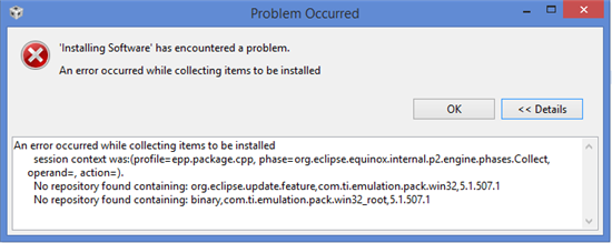

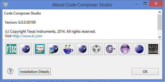

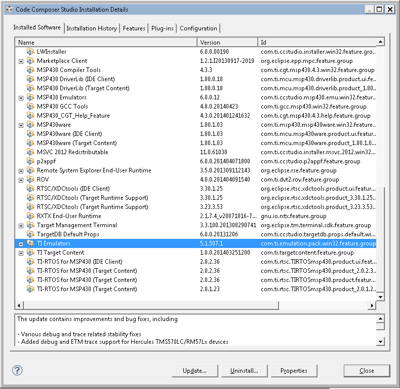

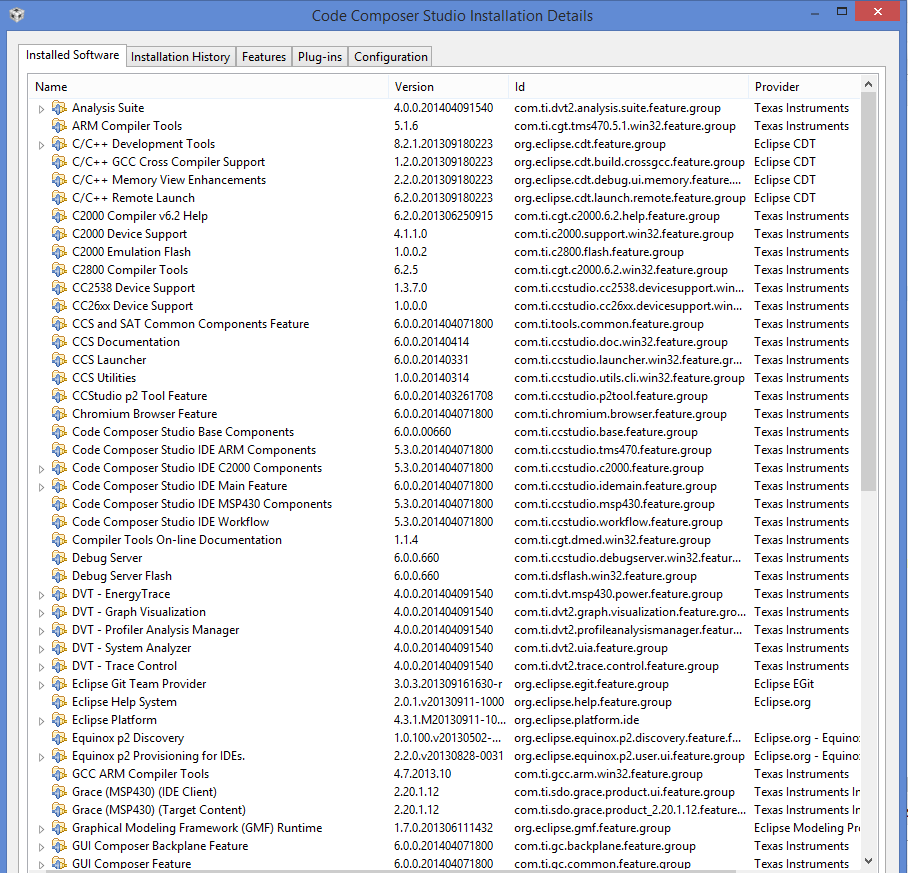

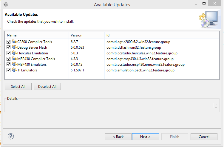

  • Hi dear sirs,
    I´m suffer for the same issue, this happens only in my Win8 64bit, but in WinXP 32bit all work fine:
    I tried to disable all windows protection mechanisms but still not work.
    The bellow update selected are the only ones that not complete due to issue reported.

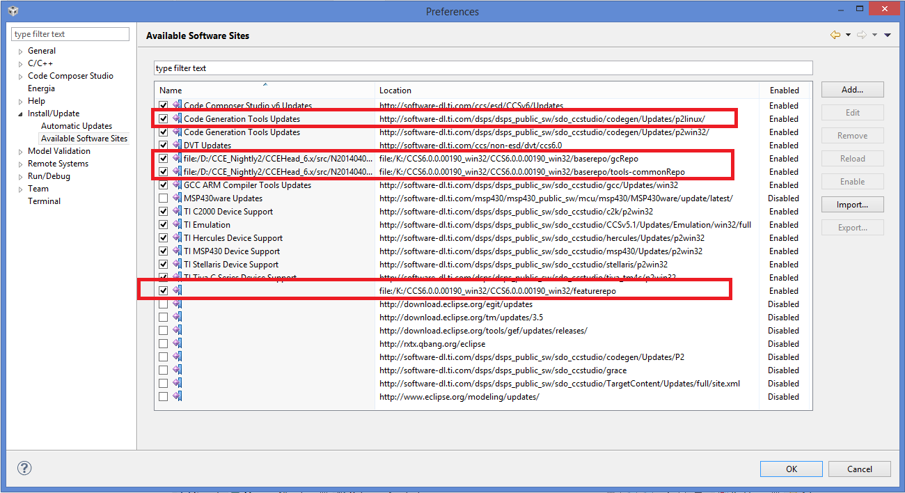

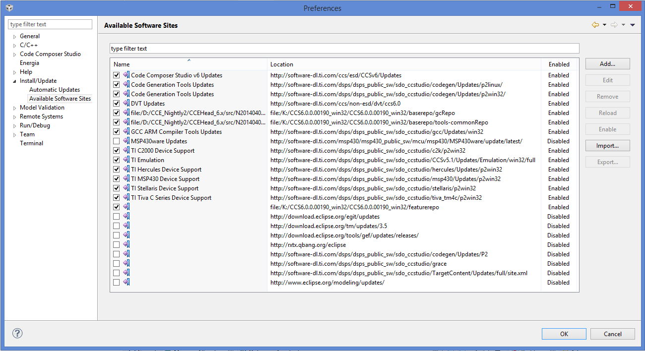

  • Tales,
    I noticed a few updates sites in your list of available sites which would not normally be present. Could you try disabling these sites and and the retry your update operation.  The sites to be disabled are:
    If you still see the error, could then try the following and let us know what happens:  Go to the help->install new software dialog. Select the "TI emulation" site in the "work with" drop-down.  Try to install this update. Does it install as expected?

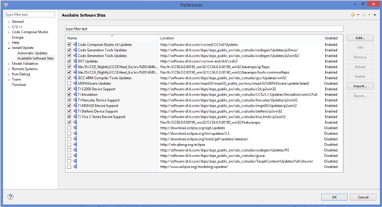

  • Frank,
    Could you also have a look at your list of available update sites on PC#2? If you see any that start with "file:" or have "linux" in the location string, could you disable those and re-try the update?
    If you are still seeing a problem could you perform the same test as mentioned above: Go to the help->install new software dialog. Select the "TI emulation" site in the "work with" drop-down.  Try to install this update.
  • Thanks dear Andy,
    I tried to disable the sites indicated above but nothing changed, so i did what you has advised as second option and follows the results....

  • Andy,
    I don't have any "file" or "Linux" sites shown on my PC#2 (see attachment).
    On my PC#1 the list of available sites is totally empty. Any ideas for this one?
    Frank

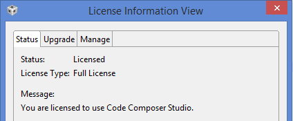

    Not sure if this is related:   On both PC's I use "Full Licenses" (PC1 :  Flexlm, PC2: Node locked). Regarding the license Manager I observed another strange behaviour:   After a few CCS-starts the "Full License" is replaced by a "free license". When I reinstall the link to the license file (PC2) or Server (PC1) CCS Switches back to "full license", but only for a few starts...

    As Frank, i deleted this two caches dir but the issue remain, after this i try to update CCS, download starts but after the below message was showed:
    I reinforce that in my winXP 32 platform all is working fine, updates were concluded without any issue unlike in my primary platform Win8 64

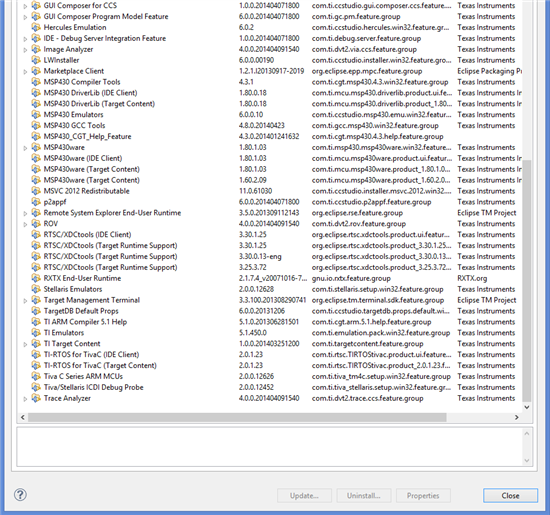

    It also appears that MSP430Ware have been updated to V1.90.. but I onlyu have 1.80.1.03 installed and get no prompts to update it.
    The display in App Center also shows "Up to Date"

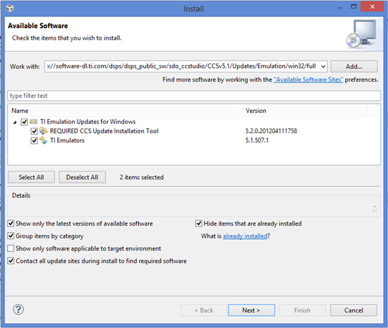

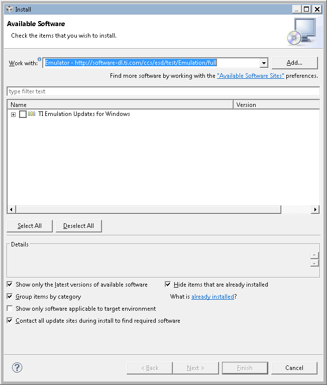

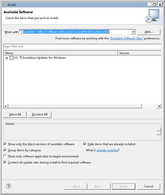

  • Tales, Frank,
    Going back to Tales post from June 27 (where Tales tried to install just the emulation update by using the "Install New Software" menu item. I have copied this same update to the locations below. The idea is to attempt to see if how the update is hosted affects what you see on your side.  Could go to the install new software menu item, and try to install the emulation update using each of the URLs below in sequence.  If one of them installs, then you will not be able to use the remaining ones. That's OK though, as we would still be getting some more data on the problem.
    When using the "Install New Software" dialog, please uncheck the option for "Contact all update sites during the install to find required software". This is in the lower left of the dialog box.
    1. TI hosted, and using third-party distribution/caching. This should be the same behaviour as the current location.
    http://software-dl.ti.com/ccs/esd/test/Emulation/full
    2. TI hosted, but not using our third-party distribution and caching provider
    http://software-dl.ti.com/ccs/non-esd/test/Emulation/full
    3. Non-TI hosted on external web-hosting provider (test site)
    http://www.go-dsp.com/sdo/Emulation/full
  • Hi Andy,

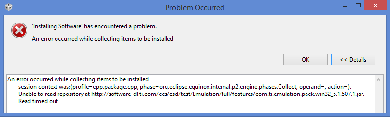

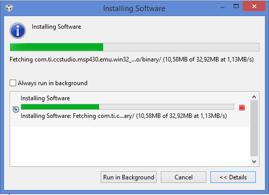

    I set up the first URL in the Install new software dialog:
    Put a tick in the checkbox and it downloaded Ok. Requested a restart and did the install with no errors.

  • Andy,
    on my PC1 (no Software sites) as suggested I used the 1st of your URL and it went through succesfully installing TI Emulators 5.1.507.1

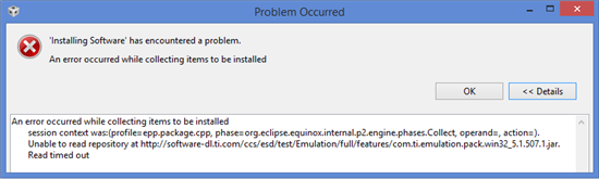

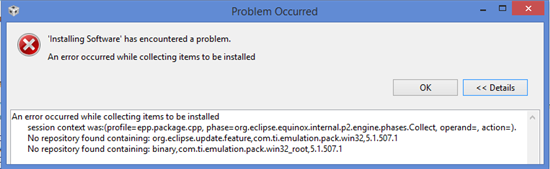

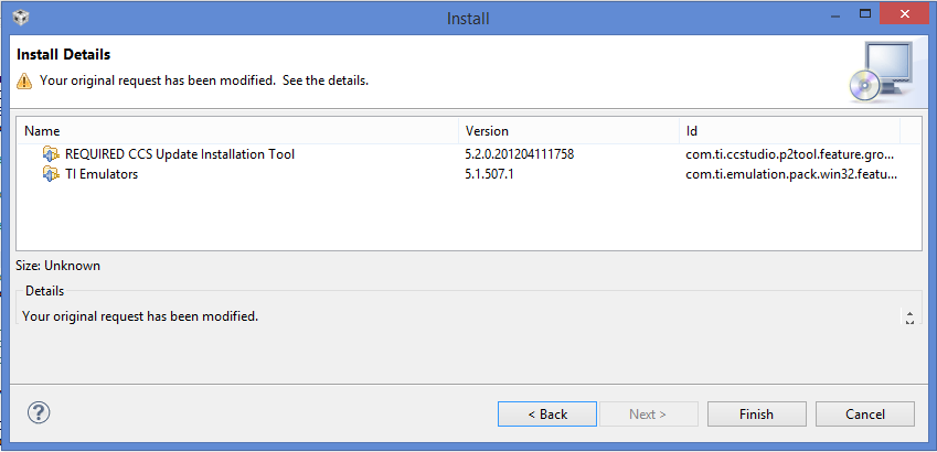

  • Hi dear Andy,
    Thanks so much for your attention,
    From my first attempt i get the following error:
    After i tried to install with the second link TI Emulation was installed successfully.

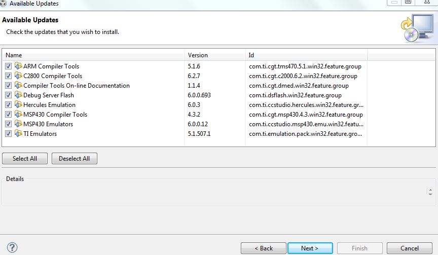

    So i tried to install the remaining updates: Hercules Emulation 6.0.3, C2800 Compiler Tools, MSP430 Compiler Tools and Emulators but many other errors was displayed me.
    I decided to proceed with the same procedure you advised me in previous case and remaining updates worked fine.
    I disabled the option "Contact all update sites during the install to find required software" in all installation procedures, but i had to do one at a time.
    Now i´m glad to show you the following print:
    Thanks Andy for your prompt attention with me.

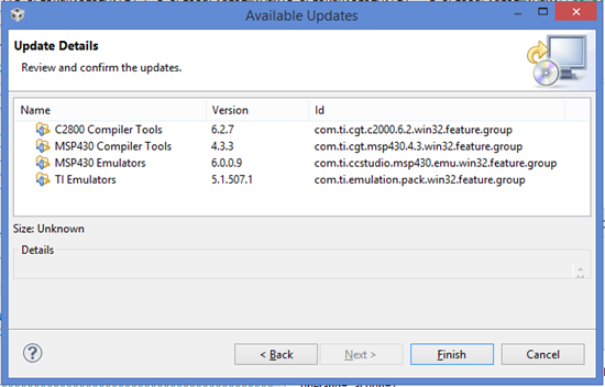

  • Likewise, I'm installing on Win 7 x64, and get:
  • Keith, I'm not able to see your screenshot. I'd like to arrange to get some other data from you if possible. Could you send me an email at the address in my profile?
