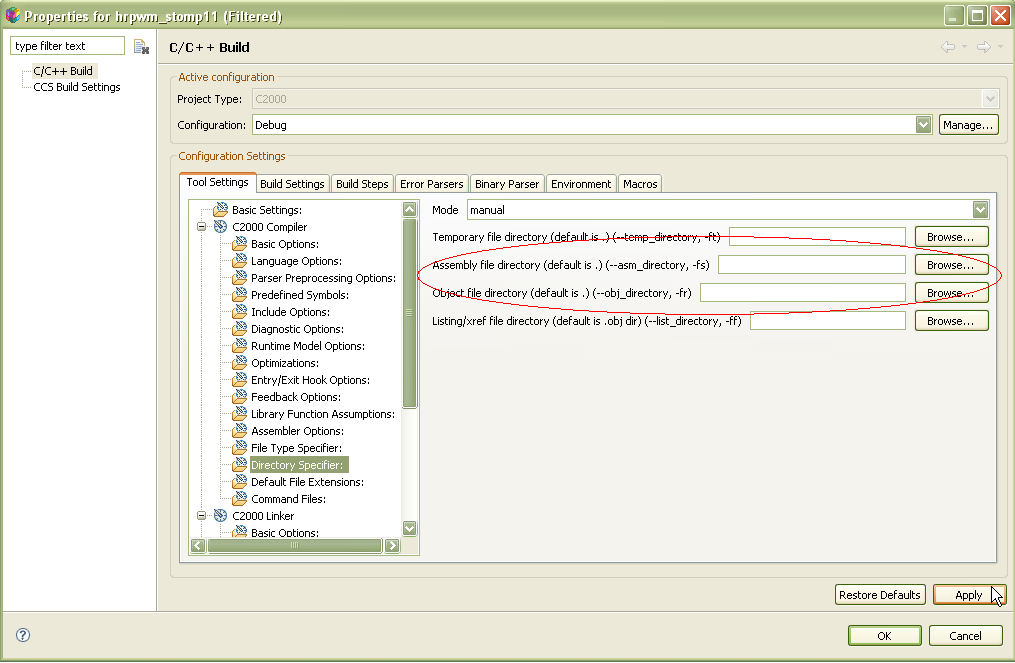

  • Help:
    I am new to TMS320F28335, and newer to CCSV4.
    Can someone help me find some simple example projects that will demo for example GPIO, PWM, ADC?
    I have examples projects for CCSV3.3, but they don't import well. I get:
    C:\Program Files\Texas Instruments\ccsv4\utils\gmake\gmake: *** No rule to make target `DSP2833x_ADC_cal.obj', needed by `Example_2833xGpioToggle.out'.
    Thanks very much.
    Blaine
  • Hi Blane,
    Could you check to see if the build options circled in the attached screenshot is empty? If it is not and you see a full path, could you try clearing it and trebuild again?
    ki
  • Ki:
    Thank you, that resolved the problem.

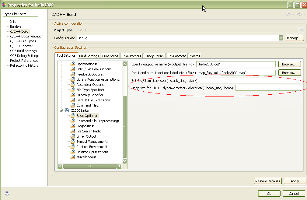

    I now get only a warning:
    creating ".stack" section with default size of 0x400; use the -stack option to change the default size  Example_2833xGpioToggle line 0 1244142974795 413
    Do you know how to resolve this warning?
    Thank you, Blaine
  • Blane - try setting the stack and heap size in the build properties (see attached screenshot) to resolve the warnings.
    ki
  • Ki:
    Thank you, that works.
