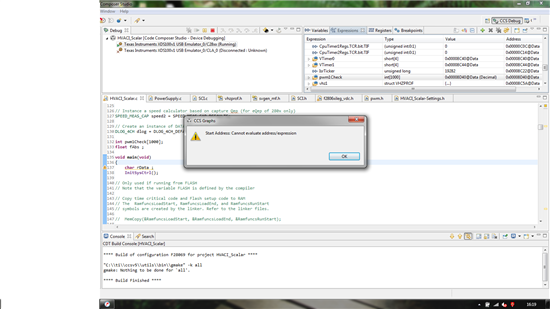

I am trying to plot a graph of a global variable, whenever i do it pops up a message "cannot evaluate address/expression". Somebody help me in overcoming this glitch.

It is not a glitch. The message is saying that the variable you entered for the graph could not be read. It could be that you had a typo, or that the debugger could not access the variable because the target is running (which I can see in your screenshot that it is running).
