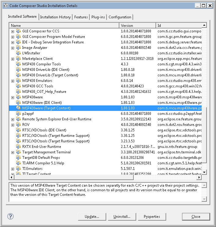

I have had some problems with my Win 7 installation of CCS V6 as it was not correctly updating MSP430Ware to the latest version. See my post in this thread
This morning I decided to do a complete re-install, so I did a complete uninstall, and deleted the remaining files in the base install directory.
I got a new download of CCSV6 for the install and as a test decided to install this on both my Win 7 machine and my older XP machine. Both installation proceeded OK. Following the initial install I then accepted to install the optional components for MSP430Ware. I also ran through the update process for both machines. I believe that the operations were identical on both machines.

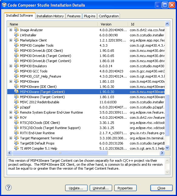

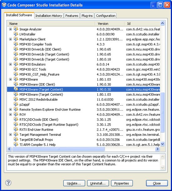

Having done this I looked at the installation details for both machines,
The Win XP machine shows that I have now got various MSP430Ware components at V1.90.0.30
However there is no sign of any components at V1.90xx for the Win7 machine.
I also generated the sample Empty project for driverlib on both machines. As expected this has generated totally different code.
Can anyone explain this behavior and let me know the best way to resolve it.

  • Roy,
    For the version of CCS that did not update the MSP430ware:
    Open CCS, go to the App Center page. Does it show you that MSP430ware has an update? If it does, can you install the update and see if that resolves your issue?
    Danish
  • Hi Danish,
    Thanks for the response.
    The display in App Center shows MSP430Ware as "Up to Date".
    I also tried highlighting the MSP430WAre and driverlib components in the installation details dialog above and using the Update button. This also comes back with "No updates were found".
    Roy

  • Hi Danish,
    Many thanks for you replies.
    I am pleased to say that both machines ran through the update process this morning with no problems.
    It would appear that the WinXP machine had somehow picked up some of the V1.90 plugins but not done the complete install.
    Both machines now have a "MSP430ware_1_90_00_30" directory under msp430 in the main CCS install dir
