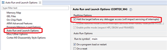

    Just as an additional curiosity/wish, is there something that can be enabled to allow for adding a breakpoint without pausing?
    IAR allows such, and it makes debugging a bit more practical, since you just leave things running, scroll the code to where your concerns are and add a break there, particularly to watch variable values. Or maybe there is a different "pause here" concept in CCS which I am blind to?
    What is happening is that when you set that breakpoint in IAR, the debugger will momentarily halt the target, set the breakpoint, and then autorun again. It happens so fast that to the user, it looks like the target was never halted. Old CCS used to work the same way. But people got confused because they assumed the target was never halted. The consensus was that people do not like debugger auto-halting the target under the hood. So this behavior was changed in recent CCS version where the target is never auto-halted. Now there is an option where you can enable this behavior back on. It is in the debugger options:
    But I have been playing around with this just now and it doesn't seem to work for me. Unless the behavior of this changed, it looks like a bug. I'll have to investigate further.
    ki
  • It looks like a bug to me. I filed one. Tracking ID: SDSCM00050528
