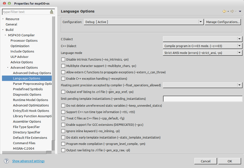

I am using configuration below, why do I get this error on CCS6 when I set the C++ dialect to C++03 mode?
Below is the error
>> Compilation failure Command-line error: invalid option: c++03 1 catastrophic error detected in this compilation. Compilation terminated. gmake: *** [base64.obj] Error 1 Building file: ../clock.cpp Invoking: MSP430 Compiler "/opt/ti/ccsv6/tools/compiler/msp430_4.3.3/bin/cl430" -vmspx --abi=eabi --code_model=large --data_model=large -O2 --opt_for_speed=0 --include_path="/opt/ti/ccsv6/ccs_base/msp430/include" --include_path="/work/c1202-firmware" --include_path="/opt/ti/ccsv6/tools/compiler/msp430_4.3.3/include" --include_path="/work/c1202-firmware/driverlib" -g --c++03 --relaxed_ansi --define=EDBUG=1 --define=__MSP430F5335__ --diag_warning=225 --display_error_number --diag_wrap=off --silicon_errata=CPU21 --silicon_errata=CPU22 --silicon_errata=CPU40 --printf_support=minimal --preproc_with_compile --preproc_dependency="clock.pp" "../clock.cpp" Command-line error: invalid option: c++03 1 catastrophic error detected in this compilation. Compilation terminated. gmake: *** [clock.obj] Error 1 Command-line error: invalid option: c++03 1 catastrophic error detected in this compilation. Compilation terminated. gmake: *** [common.obj] Error 1
Thank you for bringing this to our attention. I filed SDSCM00050535 in the SDOWP system to have this addressed. Feel free to follow it with the SDOWP link below in my signature.
Thanks and regards,
-George
Thank you, but actually I do not believe that that option is needed. The strict C++03 is the default option.
Per compiler MSP430 Compiler Users Guide 5.16
ISO C++03 (--c++03, default for C++ files)
