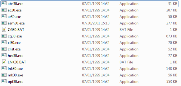

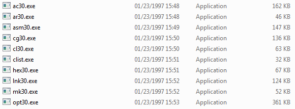

  • Hi George,
    I have a question about the compilation tool chain of C3x series.
    We have two kinds of devices and each of them use different tool chain, one is 4.70 and another is 5.11. What differences are there in the two set of compilation tool chain?
    Tool chain v4.70
    Tool chain v5.11
    I use the different tool chain to compile a totally the same file and I get the different .asm files.
    Those toolsets were released some 2-3 years apart.  In that time lots of work was done to improve the C30 compiler.  As you have seen, the differences in the assembly output can be significant.  This is all normal.
    Thanks and regards,
    -George

  • The CALL instruction encodes a 24-bit absolute address.  The CALLcond instruction (the cond can be ne, eq, and so on) encodes a 16-bit signed PC relative address.  Thus, a CALL instruction has farther reach than CALLcond.  The 4.70 compiler never uses the CALLcond instruction.  The 5.11 compiler does use CALLcond.  There is no method for disabling use of CALLcond in 5.11.
    If you continue to use 5.11, you have to contend with these CALLcond instructions which do not reach and thus get that relocation overflow message.  You can fix these on a case-by-case basis by determining which function is being called, then applying the far keyword to that function.  My first post discussed how to do that.
    If you continue to use 4.70, then the compiler will never generate CALLcond.  But you do run the risk of experiencing bugs which are fixed in 5.11.
    I can't tell you which choice is better.  It depends on how you weight these concerns.
    Thanks and regards,
    -George
