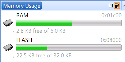

I'm trying out CCS  6.0.0.00190 with MSP430 GCC Tools 4.8.0.20140423,
and all the latest updates installed as of 11-July.
As any developer, I need to see current memory use by the project.
I'm expecting to see something like (image from Rowley Crossworks):
Even better would be a summary breakdown segregating RAM use (stack, heap, variables, free)
and flash (libraries, user code, user data).
Unfortunately, all I can find is this:
I click on "here" and nothing happens...
HELP!

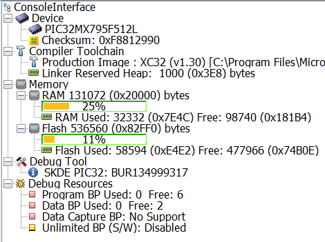

PS: Here's another example from Microchip MPLABX:
