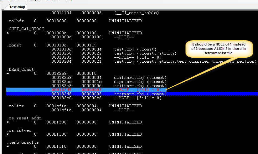

Hello Support,
Attached is a ZIP file where you can see that even though ALIGN 2 is present in the .\Debu\tctrmmrc.lst file, the corresponding CONST item is aligned to 4 Byte address in the .\Debug\test.map file.
Once you unzip the contents using WINZIP FOLDER option, you can run compile.bat file in case you want to rebuild yourself. Assuming you have the same path of 4.9.7 TI ARM compiler in your PC.
Else, you can change the path in compile.bat line
set COMPILER_PATH=
Attached is a picture of the MAP file to highlight the problem.
Let me know if you can't see the problem I am talking about.
Any help is appreciated.
Thank you.
Pashan
Linker_Bug11.zip
  • I can reproduce the behavior you describe.  I don't understand why the .const section from the file tctrmmrc.c has alignment of 4 bytes.  I think this is a bug in the assembler.  I filed SDSCM00050557 in the SDOWP system to have this investigated.  Feel free to follow it with the SDOWP link below in my signature.

  • There is no reason to try aligning things in the linker command file.  This turned out to be a problem in the compiler which is already fixed.
    The problem is the .field directive forces the section it appears in to be aligned to a 4-byte address.  And the compiler issued the .field directive as part of initializing the array within the structure.  Starting with compiler version 4.9.9, the compiler uses the .bits directive instead of .field.  The .bits directive does not force the 4-byte alignment, and gives you the 2-byte alignment you seek.  Please see this page on how to upgrade the compiler.
