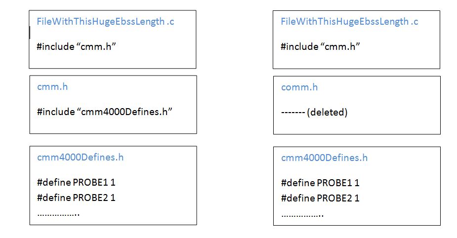

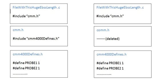

  • Thanks George. I have moved this .ebss section to other bigger data memory and I have seen a file with a huge length. Now, I know in which file I have the problem but this file doesn’t use any of the 4000 defines I have included…
    What I have seen is that this file with the problem includes one header file which includes the header file with all this defines.  If I delete this last include I solve the problem but I don’t know why....
    With this, I have the problem:                                With this, I don’t have the problem:
    Nerea
  • I am unable to reproduce this problem.  I'd appreciate if you would submit FileWithThisHugeEbssLength.c, preprocessed like this, along with all the compiler options used.
