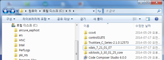

After that, I copied a file called 'xdais_7_21_01_07'.
So the files at C:\ti is now like this.

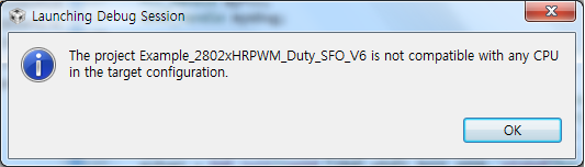

After that, I tried to debug. However, an pop-up came out like this.

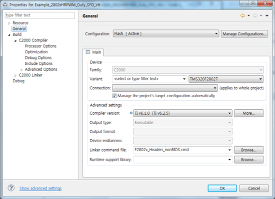

Also, this is the project setting. I didn't touch anything.
What seems to be the problem? Is it related to the free license?
    This message is telling you that there is no valid target configuration file for the project
    You need to create a valid target configuration. The easiest way to do this is to specify the target connection in the project settings. I believe the launchpad has an xds100v2:
    This will auto-generate the correct target configuration file for the project.
