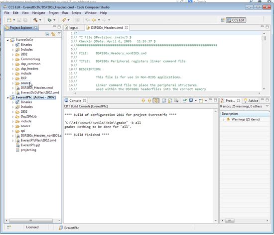

I have two seperate projects, each with their own folder. Shown below.
Each folder has its own workspace folder. (called WorkSpace - you can see it below)
Each folder has two CCS projects in it (EverestPrimary, EverestSecondary)
In each folder shown below, I have created batch files to perform builds from the command line (makePFC.bat (EverestPrimary project), makeDCDC.bat (EverestSecondary) etc).
Each folder above has a workspace folder in the root.
Below I have opened a workspace.
Each time I swap between the workspaces, it seems the other workspace is 'damaged' and my build batch files dont work.    I get the error that a project no longer exists in a particular workspace.
When I go to re-open than workspace, it is not as I saved, it , but it shows two folders, but you cant expand the projects - they havent opened.

  • Hi Nick,
    I hope you're creating a workspace with the help of CCS and not manually (by adding folders), right?
    Gautam

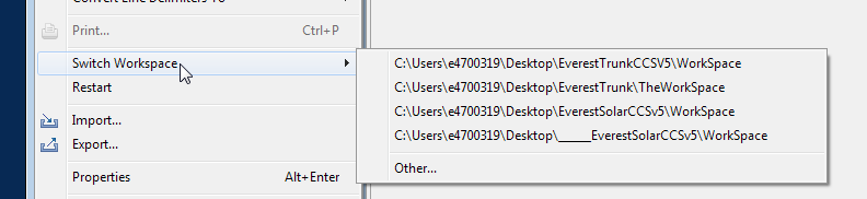

  • Cant remember how they were created Gautam.
    But I switch workspaces like below :-
    If they had been created in Windows using "new folder", and  then I had pointed CCS at it using switch workspace,  then how do I fix this problem?
    How do I create a 'PROPER' new workspace for each of my pre-existing projects?
    This is supported
    The way you are doing it (using 'Switch Workspace') or selecting it when prompted on startup as Gautam mentioned both are fine.
