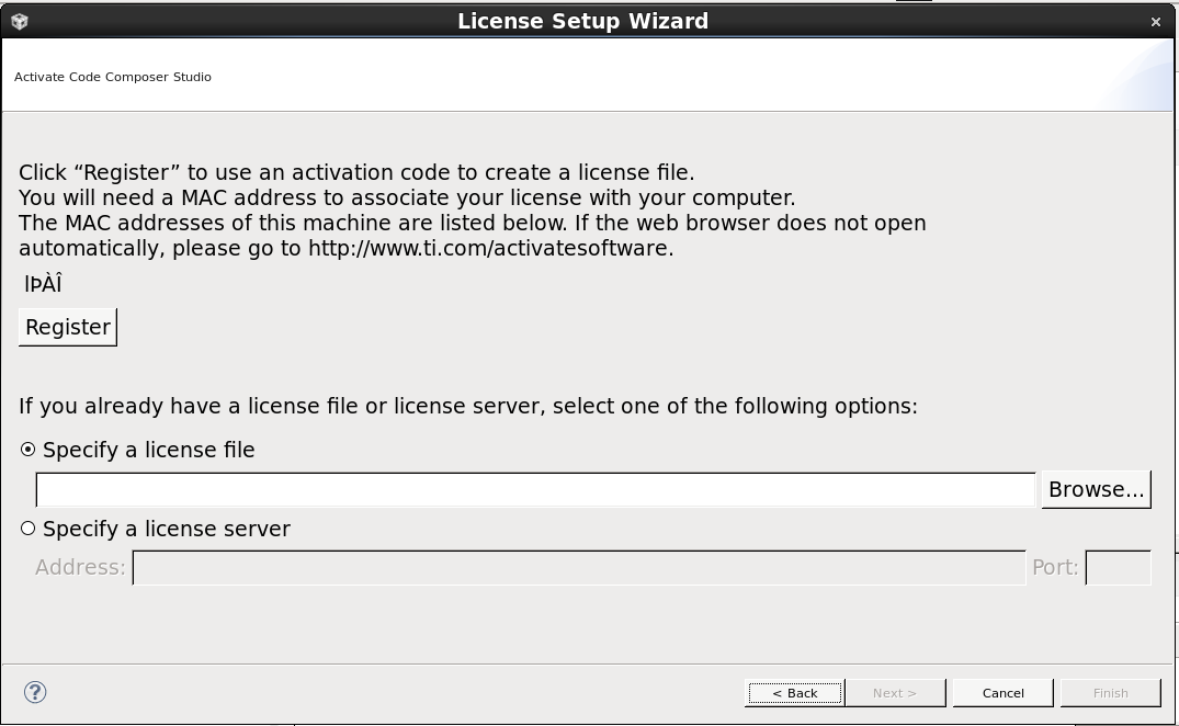

I have a node locked CCSv6 license, which was working on the primary and remote hosts. The primary host was replaced and so the license file was updated, with the primary nodeid and hostname changed.
The updated license file worked on the new primary host, but on the remote host (which hasn't changed) got a flexlm error that the hostid was incorrect:
Where the remote hostid is the second one and matches the MAC address of the wifi interface in the laptop. I think the error is that CCS 6.0.1.00039 under Linux (CentOS 6.5 64-bit) is failing to detect the hostid. If I go to the License Setup Wizard on the remote host the host ID reported is incorrect:
[The License Setup Wizard on the primary host which does accept the license shows the hostid correctly]

  • Hi Chester,
    so is it working then?   That is an odd MAC ccs is returning.  Be sure you have an eth0 address in linux.   Also be sure you didin't loose any of the redundant server settings when changing licenses.
    Lisa
    Agreed, which is why I posted the screen shot. The displayed "MAC address" is not always the same - I suspect this is highlighting some bug in CCS.
    The machine in question doesn't have a eth0 address, as it is a laptop with a wifi but no ethernet port.
  • Hi Chester,
    that might point to the issue.  As far as I am aware, CCS only looks for an eth0 MAC address .  I have seen Linux users rename a different one to create one specifically.
    But glad you are able to use ccs no problems.
