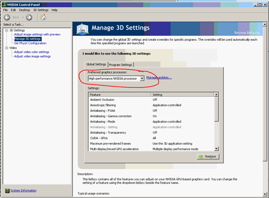

I am trying to install CC6 under windows 7 64 bit and I am stuck in a problem and I am not able to install it successfully. I do not have any antivirus or firmware running.
The installation once starts it gives me a warning about running antivirus but I do not have any antivirus and then blocks and fails
This is the log attached,  If you have some ideas let me know,

  • Marco,
    I have recently seen this problem elsewhere and would like to get to the bottom of what causes it. We have not been able to reproduce the issue locally.
    The internals of CCS installs are divided into component installers. The MSP430 component installer appears to complete but the main installer program sees the MSP430 installer as having crashed with a "segmentation violation".

  • Marco,
    To summarize what we concluded from this thread:
    • we found the msp430 installer would crash on exit when run by itself.
    • the problem is being caused by the NVidia driver. If the NVidia 3D settings are changed from auto-select to high-performance nvidia controller, the problem goes away. See the screen shot below.  We are investigating how t resolve this.
