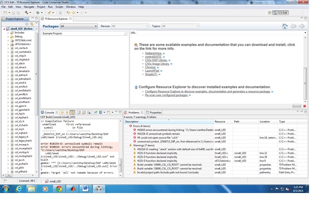

Hello All,
This is Vanitha. I have been facing issues while working with C6713 board, CCS5.2 on windows 7 machine. I have followed the steps provided by another community member to compile source code for the C6713 using CCS_v5.2 on Windows 7. http://e2e.ti.com/support/dsp/tms320c6000_high_performance_dsps/f/115/t/215890.aspx
I am getting these errors , please check the image and I have also mentioned them below,
Here are the errors (the highlighted ones),
Description Resource Path Location Type
#10010 errors encountered during linking; "C:/Users/vanitha/Desktop/DSP sine8_LED C/C++ Problem
#10234-D unresolved symbols remain sine8_LED C/C++ Problem
#5 could not open source file "csl.h" sine8_LED line 18, external location: C:\Users\vanitha\Desktop\DSP LABS\Week 2\sine8_LED\dsk6713_aic23.h C/C++ Problem
unresolved symbol _DSK6713_DIP_on, first referenced in C:/Users/vanitha/Desktop/DSP sine8_LED C/C++ Problem
warnings:
#10210-D creating ".stack" section with default size of 0x400; use the sine8_LED C/C++ Problem
#225-D function declared implicitly Sine8_LED.c /sine8_LED line 22 C/C++ Problem
#225-D function declared implicitly Sine8_LED.c /sine8_LED line 29 C/C++ Problem
#225-D function declared implicitly c6713dskinit.c /sine8_LED line 9 C/C++ Problem
Build variable 'C6000_CSL_CG_ROOT' cannot be resolved. sine8_LED properties TI Problem Marker
Invalid project path: Include path not found (\include). sine8_LED pathentry Path Entry Problem
Please help me.
Vanitha
  • Vanitha,
    I see you are probably missing the variable below that correctly points to your CSL install:
    What hinted me to reach this conclusion is the error:
    To learn how to set this environment variable, check section 3 of the page below.
    http://processors.wiki.ti.com/index.php/Portable_Projects
    This other error indicates you are missing a library - more specifically the DSK6713 Board Support Library (BSL) that probably contains the code of the function DSK6713_DIP_on().
    The thread you referenced has instructions how to download the BSL package and correctly include it in your project.
    Hope this helps,
    Rafael

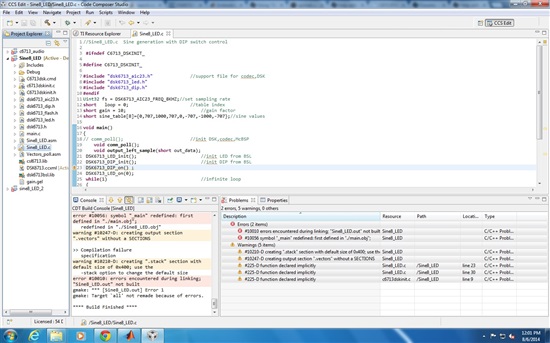

  • Hi Rafael,
    Thank you for your help.
    I created the project again with all the instructions you have given me , I don't see the previous errors , but I got the new ones which I have listed below
    Errors:
    #10010 errors encountered during linking; "Sine8_LED.out" not built Sine8_LED C/C++ Problem
    #10056 symbol "_main" redefined: first defined in "./main.obj"; Sine8_LED C/C++ Problem
    Warnings:
    #10210-D creating ".stack" section with default size of 0x400; use the Sine8_LED C/C++ Problem
    #10247-D creating output section ".vectors" without a SECTIONS Sine8_LED C/C++ Problem
    #225-D function declared implicitly Sine8_LED.c /Sine8_LED line 23 C/C++ Problem
    #225-D function declared implicitly Sine8_LED.c /Sine8_LED line 30 C/C++ Problem
    #225-D function declared implicitly c6713dskinit.c /Sine8_LED line 9 C/C++ Problem
    I have included all the necessary library files and all. Below I have attached the screenshot of my project,
    Please help me.
    Thanks & Regards,
    Vanitha
  • Vanitha,
    I can see from your project that you have <Sine8_LED.c> and <main.c>. I would remove <main.c> as it was probably included when the project was created (selecting Empty project usually helps with that).
    Cheers,
    Rafael
  • Rafael,
    I removed the main.c , and still I see the erros. I have included the screenshot
    Thanks and regards,
    Vanitha
  • Vanitha,
    I downloaded the DSK6713 package from Spectrum, and found out the function call DSK6713_DIP_on() does not exist in the included files (I see a DSK6713_DIP_get() in <dsk6713_dip.h>).
    Therefore, double-check the example code you are using and see why this function does not exist. It may be a typo or part of a file that should have been included with the example code.
    Rafael
