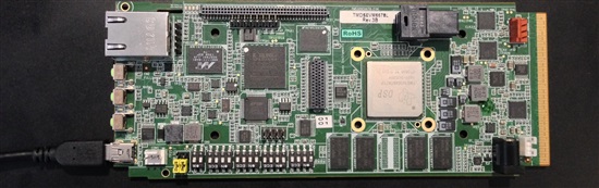

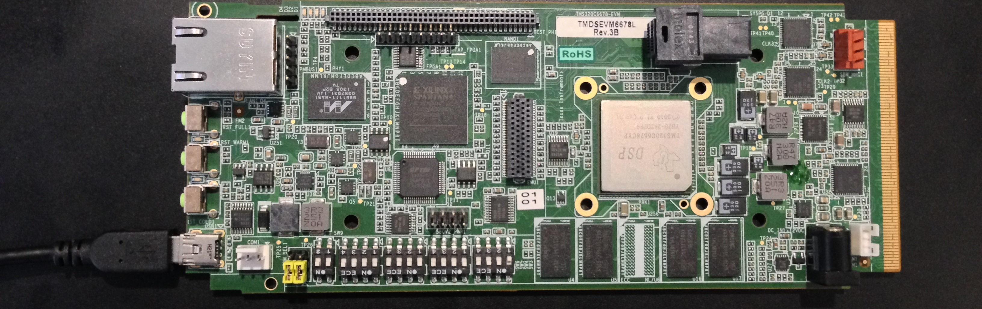

  • Desouza
    The emulator i use is on aboard emualtor XDS100V2. The connection is showing below. I had read through the thread. Yes we have similar problem, however, what mentioned in that thread did not help me.
    Thanks.
  • Xining,
    Thanks for sending the picture. You are using the built in XDS100v1 emulator, therefore I assume you are selecting this emulator in your .ccxml file, is that correct?
    Also, another striking difference I see with your board compared to all other EVM6678 boards I have ever seen: where's the heatsink and fan over the DSP?!? Did you remove them to take the picture or the board came this way?
    If there is no heatsink/fan, I suspect the DSP is either continuously resetting due to the excess temperature or it completely failed due to the thermal stress. Both scenarios would potentially cause the issues you are seeing.
    Can you confirm the details above?
    By the way, I checked Advantech's documentation to see if the fan was removed in a later revision of the board, but nothing indicates that. For details, check their website at:
    http://www.advantech.com/Support/TI-Evm/6678le_download3.aspx
    Rafael
  • Hi Desouza
    Thanks for replying. We removed the fan on the DSP. It is because we want to plug this board in our chassis. However, the fan is too high for it. And indeed, in this chassis, it has fans to cool the DSP. As we are debuging our system, so everytime the DSP was working less than 10 minutes. So I do not think this DSP is not working. I think there are some problems within this emulator.
  • Xining,
    Ok, thanks for confirming this. I hope you have at least a heatsink attached to the DSP, as airflow alone may not be enough to keep the DSP at a tolerable temperature.
    Are you consistently getting the last error message? The reason is that I get this same error message if I inadvertently select XDS100v2 in my target configuration file. For this board you must select XDS100v1. Once this is cleared you may either get a successful connection or get back to the previous error.
