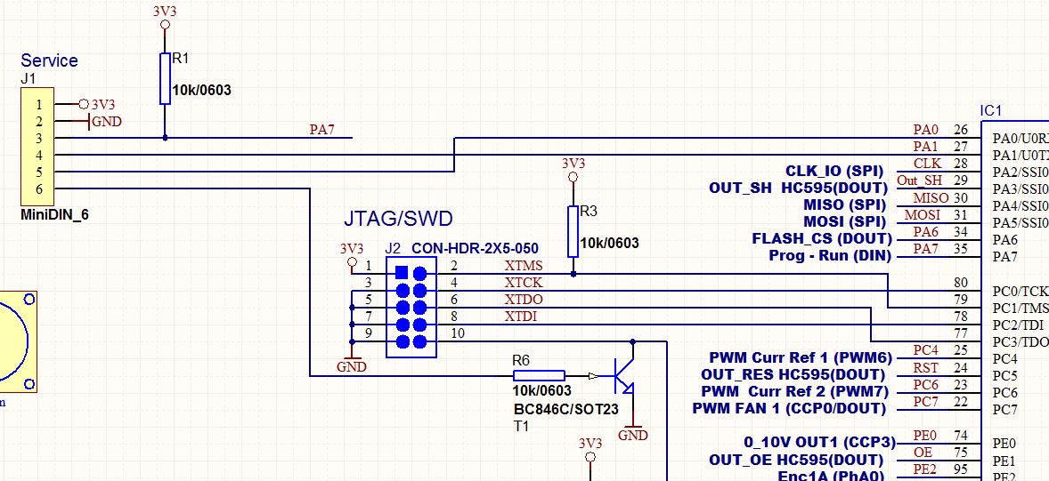

  • Hi Lisa
    My emualtors have the 10 Pin 1.27mm Connctor for ARM. For the C2000 family I use a different emulator with 14 Pin Connector.
    This is schematic of my board.
    But I have exact same problems with Stellaris Eval Board LM3S9B92. And with the older CCS I was able to work exact with the same schematic. Same problem happen with 2 different emulators.

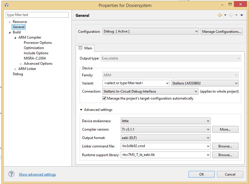

    I think it must be a problem of CCS or driver or something with compatibility or only setting. Both emulators are older than 2 years. The very strange thing is: Everythings seems like to work. No error message nothing. But the content of flash in the CPU is not updated. Why is no error message? And the connection to emulator works. LM Flash programmer can program, and CCS can debug if the content in the flash is the same like in the CCS. So hardware works. It is only the software in CCS which have the problem.

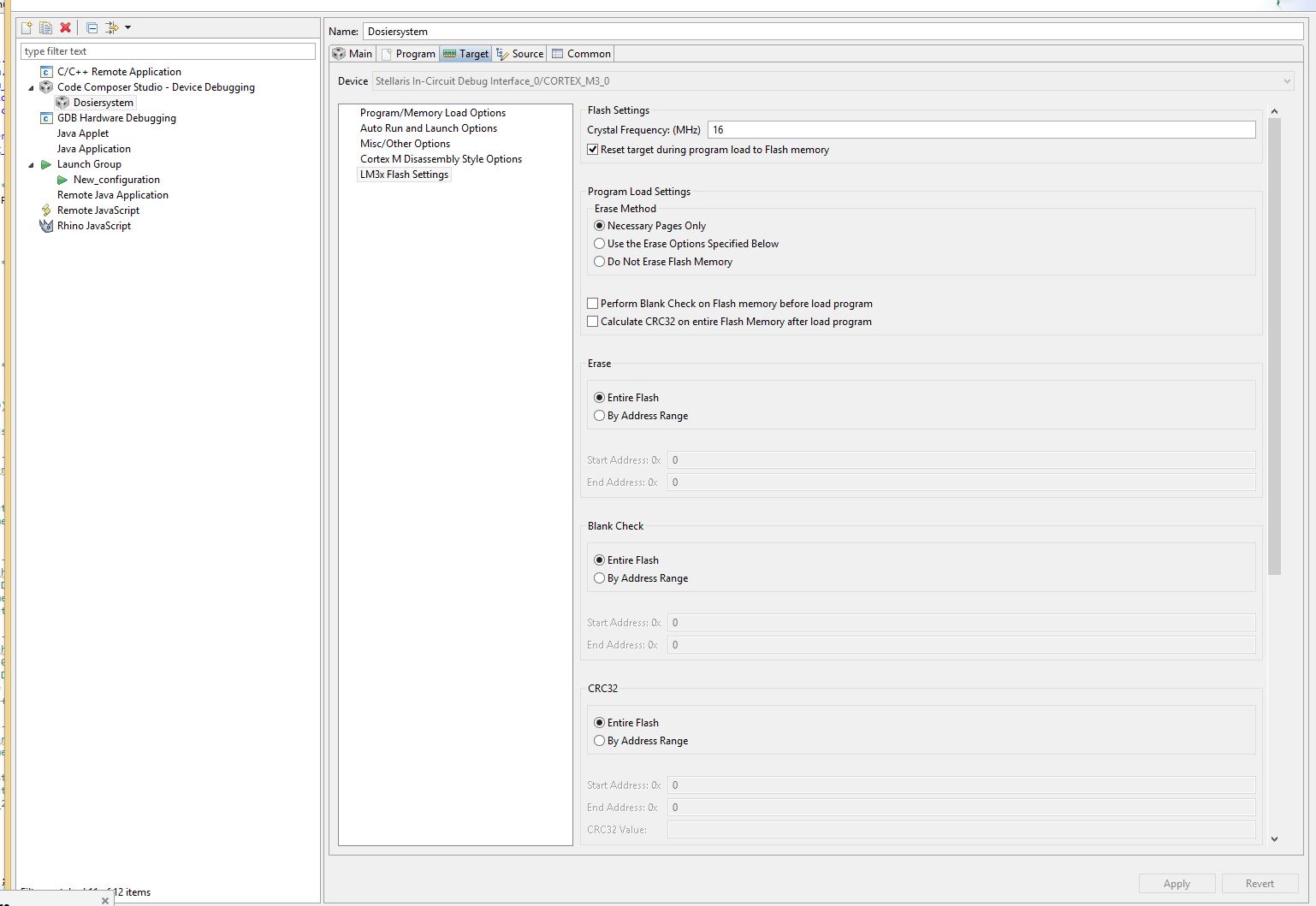

    Here some settings:
    Best regards Franz
    I am not sure why CCS doesn't update the context of flash - since your settings show that Loading Options is "Load program".

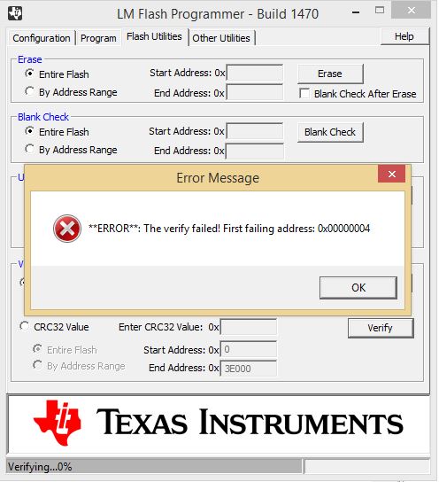

  • Here is the output if 'Enable Verbose Output'
    This seems to be ok. But it is not ok. Because when I start the debugger I have still the old programm running. The Flash is not updated. In single step he jumps very wild from position to position not according the code.
    And the LM Flash Programmer proofs it: If I verify the Flash of CPU, then the LM Flash Programmer shows an error:

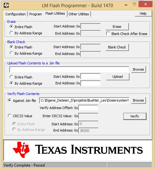

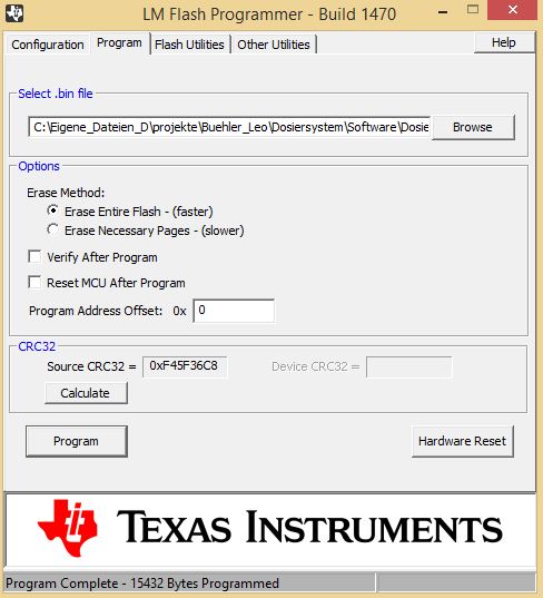

    Now I update the flash with LM Flash programmer:
    Now is the flash updated.
    Now is in the Flash what I have in my CCS5.5 project.
    Now I can start a debug session. I press the debug button. As I told you many times, now he is virtual downloading (no effect on flash). But after that I can debug my source code like normal.

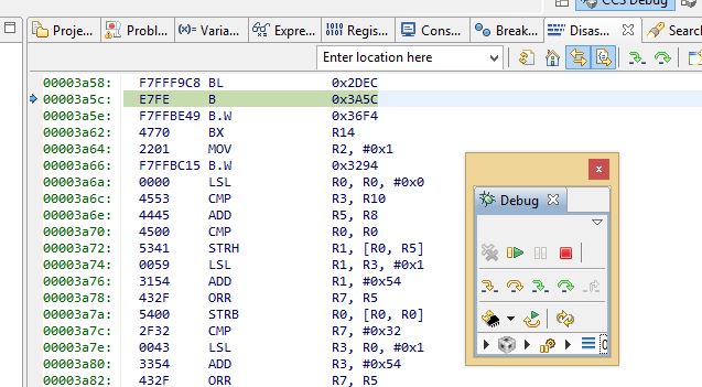

    Dear all
    Attached you find the Hello world project and the Log File in Zip Format.
    The error happened as I told you before. But this time, after download (start debug)  the execution of program startet without any additional click. When I press Pause I find the program on address: 0x3a5c.
    When I make a reset on the processor. The old program (which was programmed before 'Hello World') is start running.
