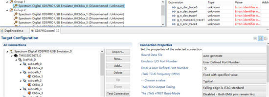

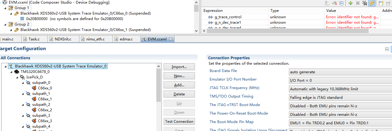

  • Hi Gautam,
    One of the emulator  is Spectrum Digital XDSPRO USB Emulator , other is Blackhawk XDS560v2-USB Mezzanine
    Emulator. and they use different  emulator  I/O port number, Blackhawk XDS560v2-USB Mezzanine use I/O port =
    0, Spectrum Digital XDSPRO USB use user defined port number 10. I use these Emulators in one target
    configurations file, and can connect to the two EVMs. And when used in two ccs, one will abort.
    Si

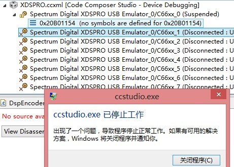

  • Gautam,
    I am sure I do not use the same emulators. Here are some pictures.
    ccs1:
    it can connect to evm board.
    ccs2:
    when I connect to the evm board, I just can connet to core0, after I core0, I connect core1, it aborts.
    Si

  • Rafael,
    The picture you pasted just connect to one core every ccs, it's also OK for me. You can try connect all core every ccs,when you connect to the second ccs, it will stop woking.
    The error shown in the message box I sent before means ccs has stopped woking, it appears a problem which leads to program stop woking normally.
    Si
  • Si,
    Thanks for reporting this. Yesterday I found out the same thing as you but couldn't reply in time - connecting to multiple cores yields to a lockup in one of the systems.
    I am still unsure what is the root cause, therefore I will reply back when I get additional details, ok? I will file a bug when I get a better idea where the issue is coming from.
