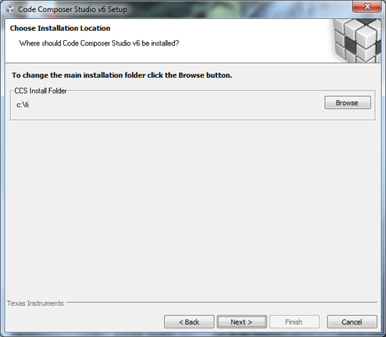

  • I downloaded 6.0.1.0040_win32.zip, but this time I can't get passed the installation directory selection.
    This could be a proxy issue since all traffic on our network is routed through a proxy server. Anything I should know about that?
    Davis
    EDIT: I ran from command line using --override-apps-url "" and the installation started. While the installer was running, I stepped away from my machine. I returned to find my machine had been restarted and it appears I have an incomplete installation of CCS v6 now. No uninstallers are available. I assume I should delete the ccs directory and try again? Please advise.
  • Davis,
    The CCS installation should not reboot your machine. Is it possible that you had an update/patch pushed down to your machine that did this during the installation?
    Please zip up all the install_logs* folders in c:\ti\ccsv6 and attach them here for analysis. It would help me understand what's happening on your machine.
    Then remove the contents of the installation directory, i.e. c:\ti\ccsv6 and install again with the --override-apps-url command.
    thanks
    Danish
  • I ran the installer a second time with --override-apps-url and the installation completed successfully. I was able to build my project as well.
    Thank you very much for your help, Danish.
