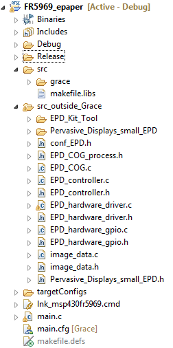

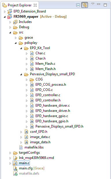

I'm trying to port the G2 example code and I probably have a ways to go still, but before I get to serious hardware debugging I have a basic compiler problem.  I have several source files in nested folders in my project like so:
These folders are set up in my includes, but the compiler does not seem to be building objects for these source files and so then when it goes to link - nothing is there.
So then it fails to build.
I'm not trying to use a library - I just want it to build the source files in the project.  What am I missing?

  • I had both projects open in my workspace and copied the files by CTRL+C the entire source directories from the example project and then CTRL+V into the new FRAM project.
    That copied the source files directly (they are present in explorer), so they should not be linked right?
    If I go to Window->preferences and look at linked resources it's blank.
    Out of desperation I just moved ALL of the source files to the root of the project and now it finally builds everything (with plenty of other errors).  That's a pretty ugly way to do it, but I guess it will work until someone can explain how to get it to look for and build source files in nested folders...

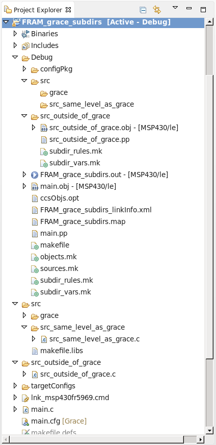

  • Nathan Crum said:
    Something about having Grace in the project is messing with the automatically generated Makefiles and it wont parse other directories for source code.
    That does seem to be the case. I note that when a Grace project is created a src/makefile.libs Makefile is created which is what I thinks causes source files manually added below the src directory to not get compiled.
    E.g. in the following project structure example:
    1) The source file src/src_same_level_as_grace/src_same_level_as_grace.c was not compiled.
    2) The source file src_outside_of_grace/src_outside_of_grace.c was compiled.
    I am not sure if this is a bug, or the intended behaviour when using Grace.

  • Lisa - it's unfortunate you think that is true.  I think Chester and I have clearly demonstrated that is not the case.  Compiler include options merely control what code is found as reference for compiling the project source (which is not the problem - header files are found just fine).  It does not control what source files are compiled into objects and later linked together (the problem illustrated here).
    Chester - thanks for narrowing down the circumstances of Grace's interference.  As long as I move my code to a folder that's not at the same level as Grace I should be fine and can resume using a nested folder architecture - much appreciated.
    -Nathan
  • Chester - I was able to confirm your description of the behavior.  I moved my  other source to a folder outside Grace and now everything compiles fine while still using Grace.  Thanks again!
