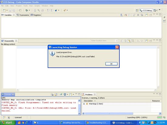

Other Parts Discussed in Thread: TM4C1294NCPDT
Board :- Board Booster Pack Tiva C Series TM4C1294NCPDT
IDE : TCCS V5
System OS : Win XP 64Bit
IDE : TCCS V5
The debug server log file shows that the Program Load is using the "Necessary Pages Only" option to erase flash - which has been seen to cause a "Timed out while writing to Flash memory" error.Muralidhara S.N. Sullia said:
As per http://e2e.ti.com/support/development_tools/code_composer_studio/f/81/t/328195.aspx try setting the option to "Erase Entire Flash".
Murali,
Let us know if Chester's workaround enabled you to load the program. Also just FYI, many known issues have been fixed in newer versions of CCS, so if at all possible I would recommend updating to the latest version of CCS (6.0.1).
