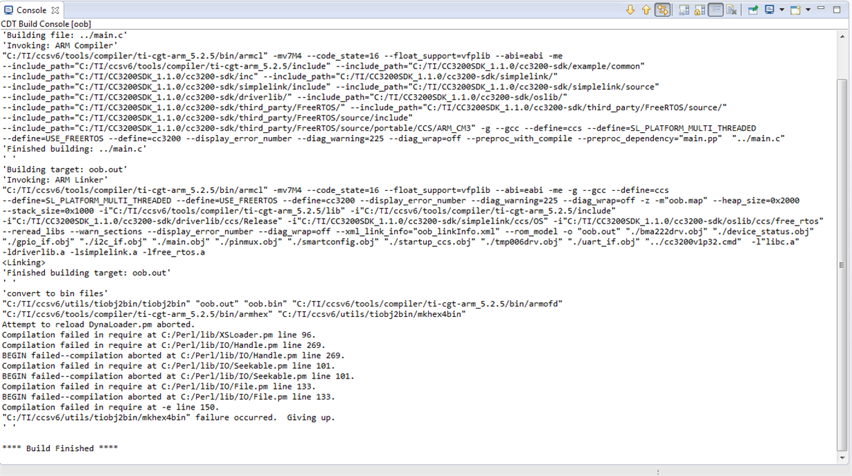

  • HI LISA
    I got same problem..
    my debug console so me following error.
    What should i change?
  • Hi Markel
    Please help me I coudn't generate .bin file.
    I get the following error.
  • Hi Pulkit,
    Have you tried building a CC3200 SDK example program and check if the .bin file is generated?
    From your log message it is not able to compile .pm file. I do not know if CCS can compile .pm file, so wait for a TI Engineer to reply regarding that.
    I also suggest that you use a already working example program as base for your development. That way you already know that it is able to generate .bin file.

  • Hi Markel
    Thanks for giving fast reply.
    Yes I also tried to build Ready SDK also but it also gives me same error.
    what should I do??
    Should I reinstall CCS?
    Let's wait for TI Employee.
