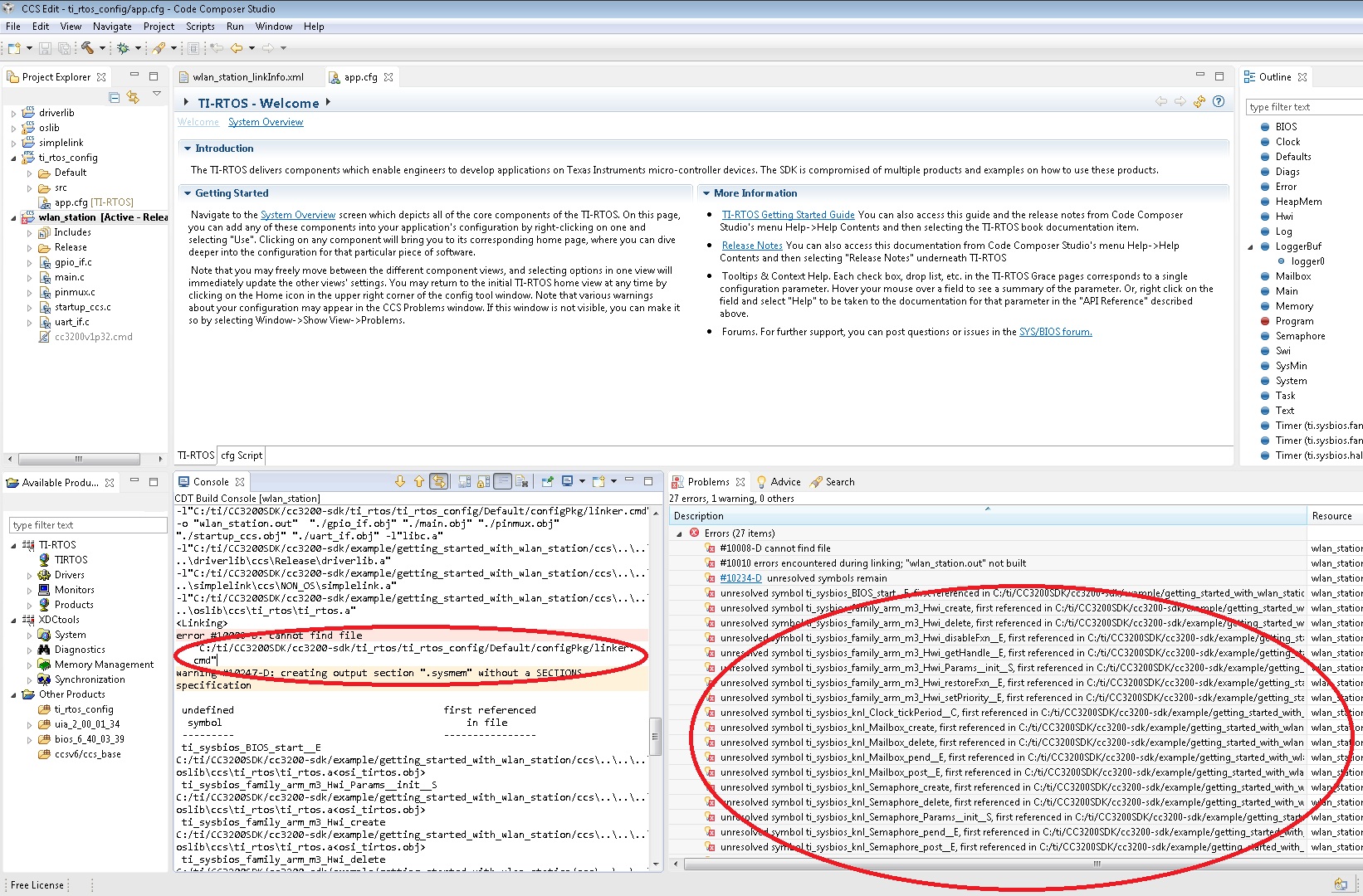

Im working with CC3200 Launchxl 3.2 and wlan_station from SDK 5.2.
Nothing worked directly. I tried so many things from forum.
1) With FREERTIOS linked to wlan_station builded successfull. But nothing worked.Its hanging in vApplicationMallocFailedHook under main.
2) I couldnt make linker.cmd out from ti_rtios build and have "xdc.tools.configuro: missing input config script"
3) With TIRTIOS linked to wlan_station i have errors in picture.
4) With Uniflash, i loaded orignal "wlan_station.bin" and also didnt worked.
I was able to get the wlan_station example built without problems in CCS 6.0.1. I simply imported the ti_rtos_config and wlan_station projects into CCS and was able to build without errors.
As far as the example itself not running as expected, I would suggest posting that question to the SimpleLink forum for the experts there to comment on.
