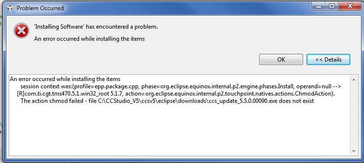

Today I wanted to install new Code Generation Tools for ARM (V5.1.7) in my CCS V5 (5.5.0.00077).
As often seen with CCS this did not work.
I get the following error message:
Any ideas why this software looks for a file "ccs_update_5.5.0.00090.exe"?
And please do not tell me to uninstall and install again.
Patrick
  • Patrick,
    This is tricky, because the install instructions for arm 5.1.7 don't contain any chmod statements.  Were you installing/updating more than one component? Could you try the following:
    Shutdown CCS
    Delete the cache folder in install directory ->ccsv5\eclipse\p2\org.eclipse.equinox.p2.core
    Delete the cache folder in install directory ->ccsv5\eclipse\p2\org.eclipse.equinox.p2.repository
    Restart CCS and only select the arm 5.1.7 code gen tools for update.

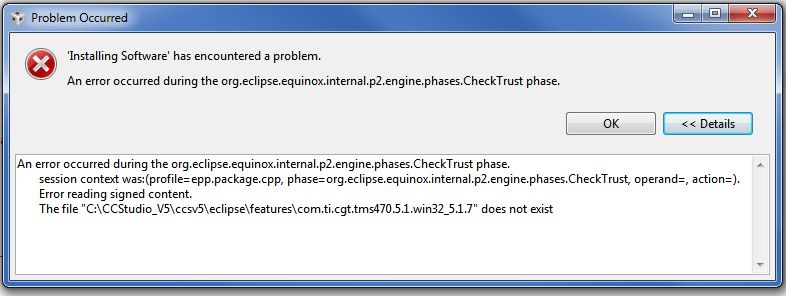

  • Hi Danish,
    I did what you said and I have also run CCS V5 with the "-clean" option.
    No I get the following error:
    Firewall and Anti-Virus is deactivated.
    Patrick
  • Hi Danish,
    Any news on this topic. I'm still not able to install ARM Code Generation Tools.
    Patrick
