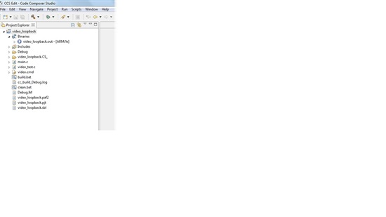

I am using Zeiss DM6446-wifi Evaluation Module with CCS v5.3. The projects for the same processor is available from Spectrum Digital Website. I have downloaded the projects,they are built using CCS v3.3.I am trying to import the project in CCSv5.3. The project gets imported succesfully. Screenshot is as follows
If I try to load .out file for this project, it works fine, But if I Rebuild the project, it shows compilation failure.

NOW,as per my understanding even if I sppecify both the library paths in the project properties it shows error.
kindly suggest.
