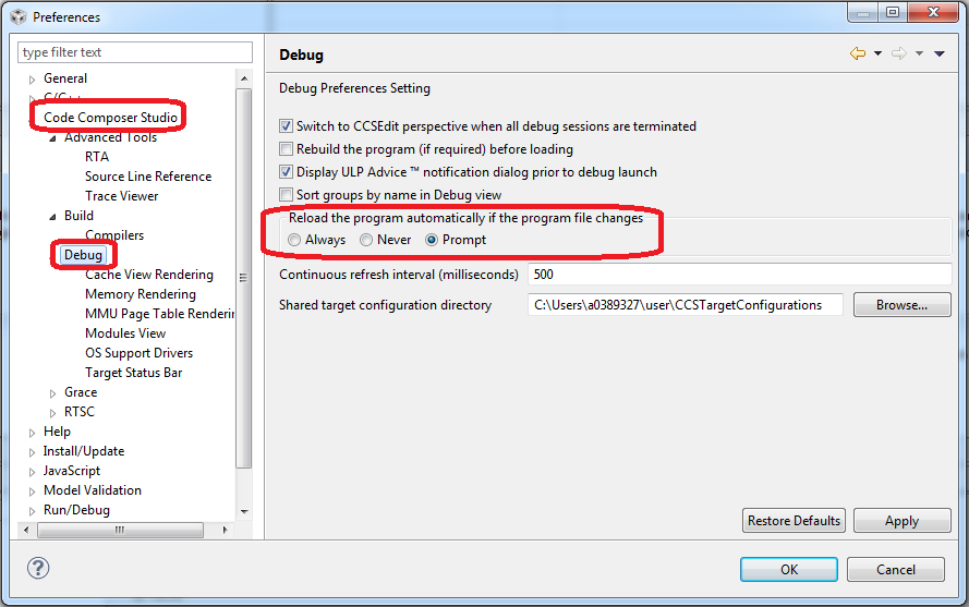

Automatically load OUT file after build
Where is the setting in CCS to enable/disable this feature?
When I am connected to the target, I want to reload the OUT file after a build, if there is a change.  By default, this is enabled, but I accidentally hit NO and can not find the setting!
HELP and searches failed me.  Please please do not kill me if this has been asked many times before.
