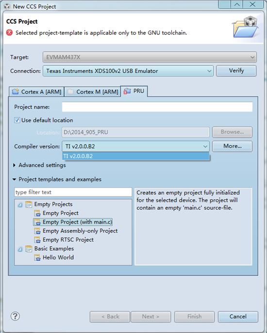

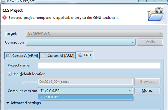

HI everyon
i'm using code composer studio v6.0 with an EVM AM437x and i can't create a new project about PRU
Where can I find the PRU GUN,
Please advise what to do
Thank you

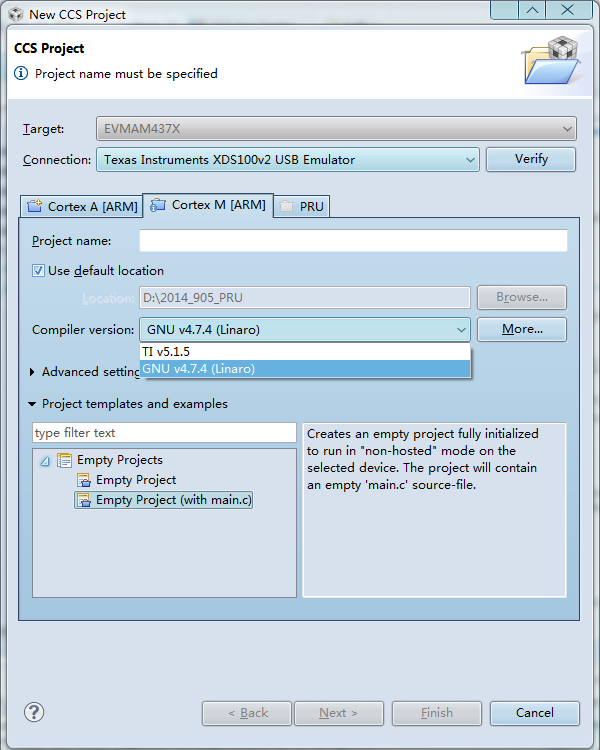

Thanks. I see the issue now.
You are using the SYS/BIOS example for AM437x. It's strange... if you pick the Cortex A example, it requires you to use the GCC compiler, even if you just want to use the PRU tab. If you pick the Cortex M example, it requires you to use TI compiler so you can use the PRU tab. This is confusing and we need to clean this up.

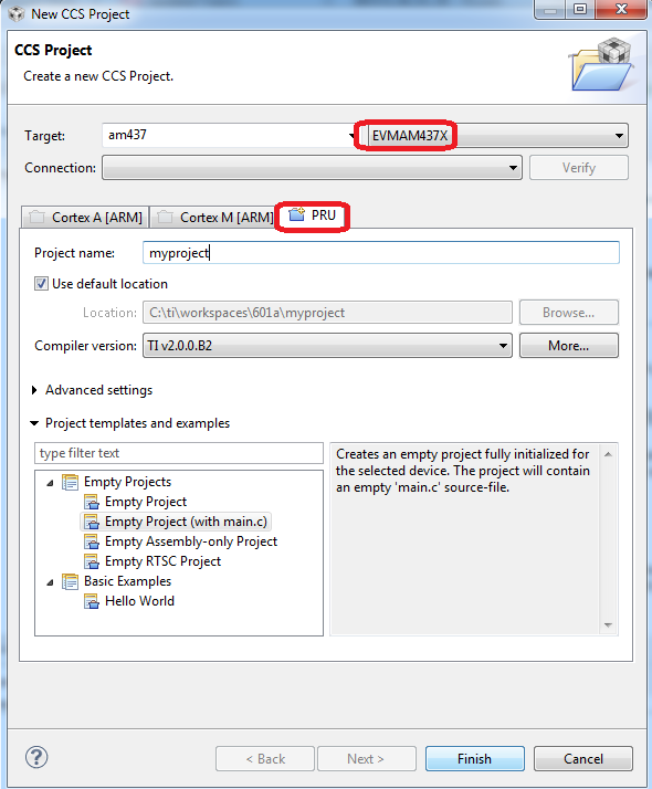

If you want to create a PRU project, I would not use one of the SYS/BIOS examples but instead create a PRU project from scratch using the New Project Wizard for AM437x (Project -> New CCS Project)
