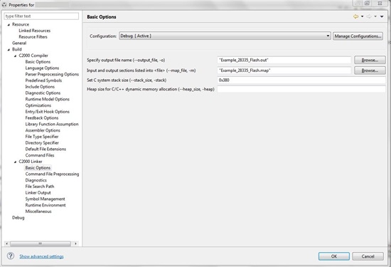

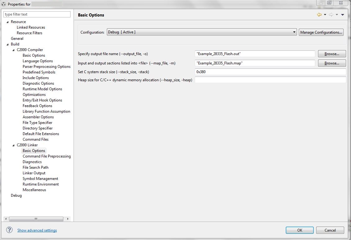

    Check your Project Properties -> C2000 Linker -> Specify output file name. What does it indicate?
    Gautam
  • I do progam the MSP430F5437A so there is a slight difference to your picture, but it looks the same as yours, there is one, outfile and one map-file

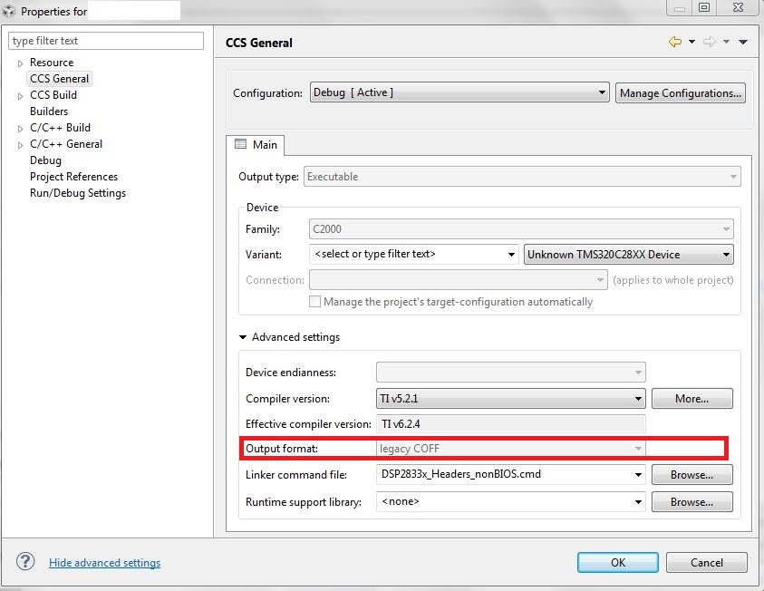

  • Also, what does your this window indicate:
    If it indicates elf then try changing it to COFF. As you mentioned above, yes both have different Information Format and hence the .out file size would vary. Just try manually modifying the same to COFF and let us know what you observe.

  • Hmm ok thanks again, but as I stated above I already know i can switch and it works, but I do not understand exactly why TI did it what is better to manually change it with CCS 5.5 or to still use CCS 5.1 for my old projects in acutal products of ours.

    ELF is more of a standard and more widely used than COFF, and also has several compelling features that are not there in COFF, a short summary of which is here. Hence most TI compilers currently default to the ELF format when creating new projects in CCS. As you noted, the COFF format is still supported.
    If you have existing COFF projects that were created with an older version of CCS, you can simply import then into CCS 5.5 and still use the COFF format. Importing the project should not change its existing output format. If you create a new project in CCS 5.5, it will default to ELF, but you have the option of changing the format to COFF. So there is really no reason to stay with CCS 5.1 for old projects.
