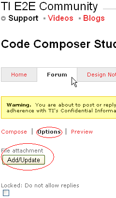

    I dont know how to attach a .dmp file into the thread ?
    where is the function ?
    thanks!
    Hugo
  • The function for attachments is available under the 'Options' section:
  • I have uploaded the dmp file
