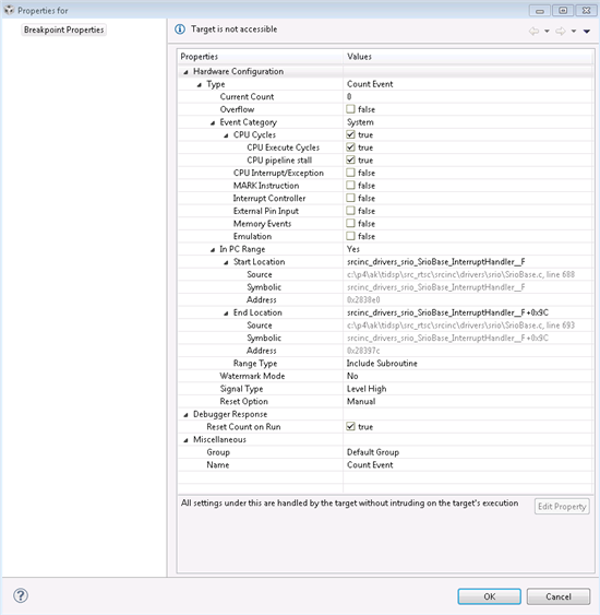

I'm currently working on optimizing a high frequency interrupt on a C6472. I'm attempting to understand why it is taking so long. System analyzer states that it takes on average 4us to complete. When I turn on a hardware count event which counts cpu cycles between the beginning and end of my ISR (inclusive of subroutines) it comes back with 470 cpu cycles. With a 625MHz clock, that is 5x faster than 4us.
Is the count even acting like I expect? based on system performance, the 4us from system analyzer looks correct.
I was hoping to avoid placing lots of Log_write statements in my code, and just use the same binary and move the count event start and stop locations.

    Also, how are you setting up the hardware count event? Is it the "Profile Cycles" event via the Breakpoints view or using the Profiler Clock? Do you have a test case that you could send?

    Here is the breakpoint type I am using:
    My guess is that you don't have to use a HW interrupt to verify it. a SWI with a bunch of function calls nested 2 to 3 deep would do it.
