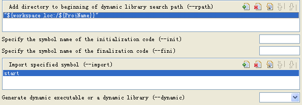

Also, I want to call the start function in other ccs project, so I :
1.added import and export symbols
2:rebult the project
3. add the dll in another ccs project " test" which is simple like:
int main(void) {
    start();
    return 0;
4. added the dynamic lib path and import symbol to the test project
4. built test
**** Build of configuration Debug for project test ****
"F:\\ti\\ccsv5\\utils\\bin\\gmake" -k all
'Building target: test.out'
'Invoking: C6000 Linker'
"F:/ti/ccsv5/tools/compiler/c6000_7.4.1/bin/cl6x" -mv6600 --abi=eabi -g --display_error_number --diag_warning=225 --diag_wrap=off -z -m"test.map" -i"F:/ti/ccsv5/tools/compiler/c6000_7.4.1/lib" -i"F:/ti/ccsv5/tools/compiler/c6000_7.4.1/include" --reread_libs --warn_sections --display_error_number --diag_wrap=off --rom_model --rpath="F:/myworkspace_v5_3/test" --import=start -o "test.out"  "./main.obj" -l"libc.a"
<Linking>
warning: Option --import is not valid without --dynamic or --sysv or --rom (ignored)
warning: Option --rpath is not valid without --dynamic or --sysv or --rom (ignored)
warning #10210-D: creating ".stack" section with default size of 0x400; use the -stack option to change the default size
 undefined first referenced
  symbol       in file
 start     ./main.obj
error #10234-D: unresolved symbols remain
error #10010: errors encountered during linking; "test.out" not built
>> Compilation failure
gmake: *** [test.out] Error 1
gmake: Target `all' not remade because of errors.
**** Build Finished ****
Q3: Is this the right  way to call functions from in a dll?
Q4: if Q3 is no . Then how to call up a dll?
