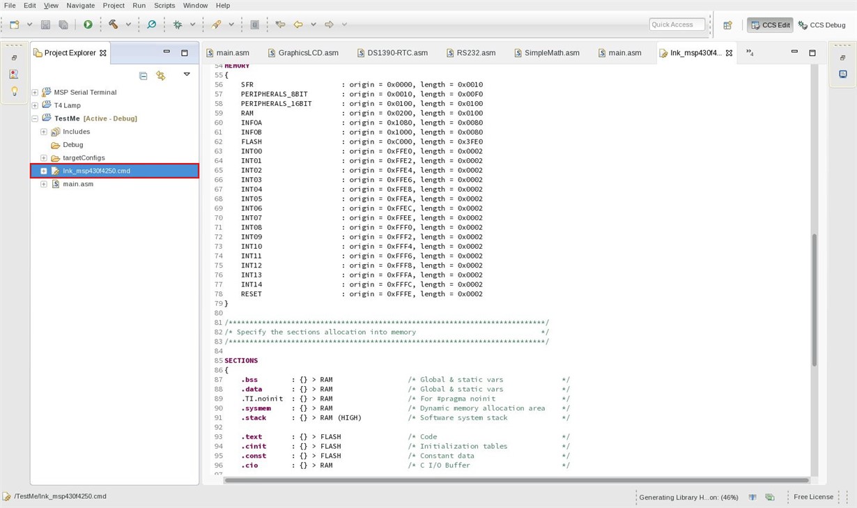

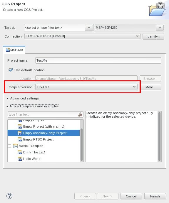

I am having a problem creating new assembly only projects in CCS. Every new project I create I get the same error "No source available for "0x0"". Projects imported from CSS5.5 compile and run fine. I can write new code into old CCS5.5 projects an run it. I have used the default code prefilled by CCS6 as well as deleting the prefilled code and replacing with working code from a CSS5.5 project and neither worked. I have defined the entry point in the code as well as the linker options. I have also tried both the eabi and the legacy COFF output formats.
I am running Windows 8.1 and CCS6.01. The device is a MSP430FG4618 connected via a MSP-FET430UIF. The UIF has been updated to the latest firmware. I have included a copy of the prefilled code with the entry point defined. I have also attached a screen shot of the error.
This error was reproduced by a TI representative using a different computer, MSP430FG4618 and the new interface module during at the opening of a new engineering laboratory at my university. He would also like to be informed of the response to this issue. Thank you.
