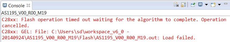

I'm having a problem with CCS V6.0.
This morning, I was able to load the program in my TMS320F28062F, but now it doesn't work anymore.
I receive this error message :
It is strange because when i click on the debug button, I only see the loading process, the flash erase process is skipped.
I tried :
- to restart CCS, no changes
- to make a copy of the workspace and rename it, no changes
- the test connection is working, you will find the result below

  • Sebastien,
    Can you check your Flash settings to make sure it is erasing the Flash before programming? This should be the default if you haven't changed it, but just in case, let's look at that first.
    Right click on your project and choose Properties, and choose the Debug tab. Look in the Flash Settings and make sure the "Flash program Setting" is set to "Erase, Program, Verify".
    If the setting is correct, the next time we can check is to see if a standalone erase operation is working. To do this, launch a project-less debug session (by right clicking you ccxml file and choosing Debug As Code Composer Debug Session), connect to your device, and bring up the On-Chip Flash (under the Tools menu). Then look for the "Erase Flash" button and see if the erase operation is successful or not. If it is, try to load the program again.
    Please try this and let me know your results. Let me know if you have any questions.
