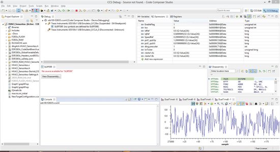

  • Good news, it seems the problem has been fixed. The problem seems to be 2 things:
    1) The DC voltage input was insufficient and not correctly wired (I didn't have the DC supply unit that came with the kit, so I used one that I bought but it was connected backwards plus-ground, ground-plus). This caused the "stuck at one" error, since after correcting that, the connection test was OK.
    2) In order to run the program I didn't just press debug, I had to go to target configurations and select "Launch Selected configuration", then "Connect to target", "Load Program" and it flashes the card (I verified it).
    I'm still having problems debugging the program, since it seems it doesn't run because of error "No source available for "0x3ff599", but one step at a time, I'm going to look for a solution for that in the forums before asking again.

    I don't see answers, I've read it a couple times to see if there was something that I wasn't seeing, but either there ins't or I don't get it. They talk initially of another problem (similar to my own), they work it out somehow and then they talk about the same error I'm having but their solution is "minimize the tab", except that in their case the code runs (in mine, it doesn't).
    But I guess that a picture is worth more than a thousand words.
  • I forgot to comment, the picture uploaded corresponds to a procedure described in this post:
    http://e2e.ti.com/support/development_tools/code_composer_studio/f/81/t/200643.aspx
    More precisely this one:
    This message is simply saying that there is no source code equivalent to the reset vector but if you open the disassembly window, you should be able to see where you are halted. If you then do a Restart you will likely halt at "main". From there you can run your program.
    I will report the issues with the newer 2xPM_Sensorless_v1_1 example to the C2000 team. Thanks for your patience.
    I did as adviced and the previous picture is the result, still not being able to run the code.
    These are the key quotes from the thread:
    Brian: "I've been receiving the message "No source available for 0x3ff8a1" once I build/load my code. I understand that 0x3ff8a1 is the starting memory location when the processor is reset, which I confirm using the disassembly window"
    Aarti: "As you already mentioned, this message appears if you are halted at a location/portion of code where no source file is available. Unfortunately, there is no way to prevent the message from coming up"
    Yes this is the same as the other thread.
