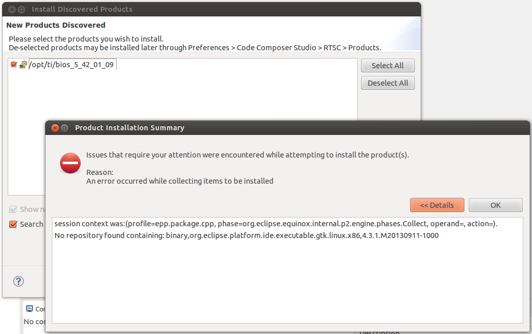

CCSv6 recognizes DSP/BIOS 5.42.01.09 but cannot install it
Other Parts Discussed in Thread: CCSTUDIO
My CCSv6.01.00040 (for Ubuntu 12.04 LTS 64-bit) recognizes the DSP/BIOS 5.42.01.09 version installed in /opt/ti/ but at the end I'm not able to install it. Here's the message shown by the IDE:
Could somebody help me with this issue?

  • The same versions of CCS and BIOS work for me on Win7 64b.  I will put them on a Linux image tomorrow and give it a try.
    I see your BIOS is in opt.  Is ccs there as well?  I am assuming you installed as sudo, are you running as sudo?  Might be worth giving running as sudo a try as there is an "installation" portion to selecting a version of BIOS.
    John
  • Hello John,
    Yes indeed, I've installed CCS as sudo but if I running it in the same way I get the next message:
    gaston@gaston-XPS13:/opt/ti/ccsv6/eclipse$ sudo ./ccstudio
    [sudo] password for gaston:
    # An unexpected error has been detected by Java Runtime Environment:
    #  SIGSEGV (0xb) at pc=0xbad2892c, pid=2450, tid=3153296192
    # Java VM: Java HotSpot(TM) Client VM (11.3-b02 mixed mode linux-x86)
    # Problematic frame:
    # C  [libnssutil3.so+0x892c]  NSSRWLock_LockRead_Util+0x1f
    # An error report file with more information is saved as:
    # /root/.ti/ti/0/dmp/hs_err_2450.log
    # If you would like to submit a bug report, please visit:
    #   http://java.sun.com/webapps/bugreport/crash.jsp
    If I run CCS from desktop icon IDE starts as usual but I cannot install the BIOS package. I attach the log file to give you more hints.

  • BTW, CCS is in opt/ti as well
  • Try adding -DTIBrowserType=swt to the ccstudio.ini file in /ccsv6/eclipse
    It looks like the chromium browser is crashing.  Adding this line would switch CCS to use firefox.
    john
  • John,
    Thank you, it works fine now!
    But it's strange, I have no chrome products installed.
    regards,
    gaston
  • We install a redistributable version of chrome called chromium.  We use it as the internal browser in CCS (getting started view, app center, gui composer...).  I believe that gui composer will have issues without it but chances are you are not using that tool anyway.
    John
